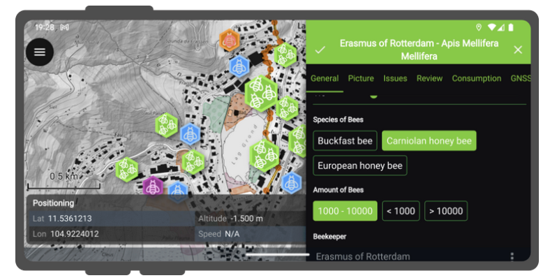

  • The feature form’s value relation widget gained grouping capabilities to enhance ordering of items
  • The feature form’s value map widget gained a toggle buttons interface for faster data entry and an item filtering for large combobox lists

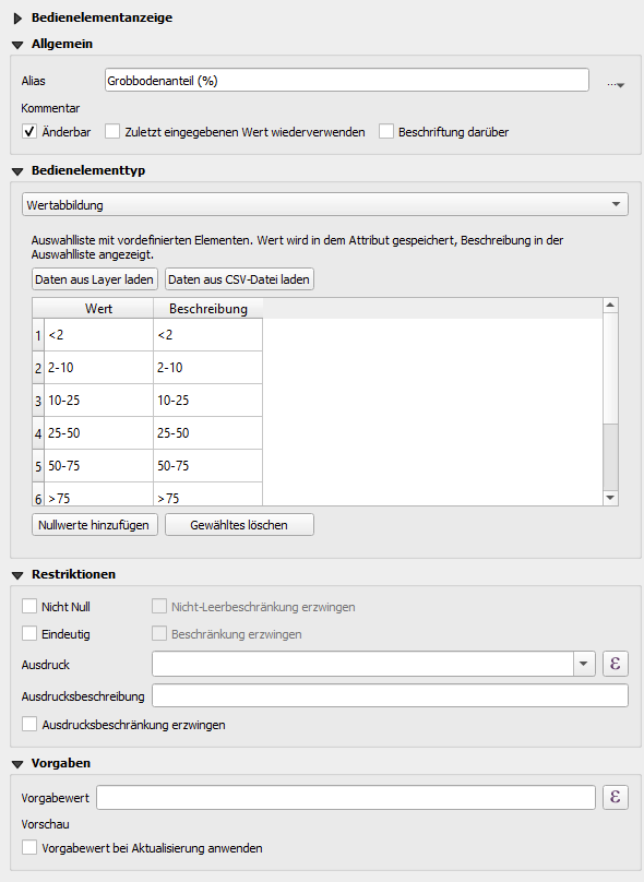

From my understanding of QField such features like the layout/settings of the attribute form are configured in the QGIS project itself. However in my current QGIS version 3.28 I cannot figure out where to enable in example the toggle buttons for the value map widget.
Therefore, my questions: Are these new settings configured in QGIS? What version of QGIS would I need for the configuration?

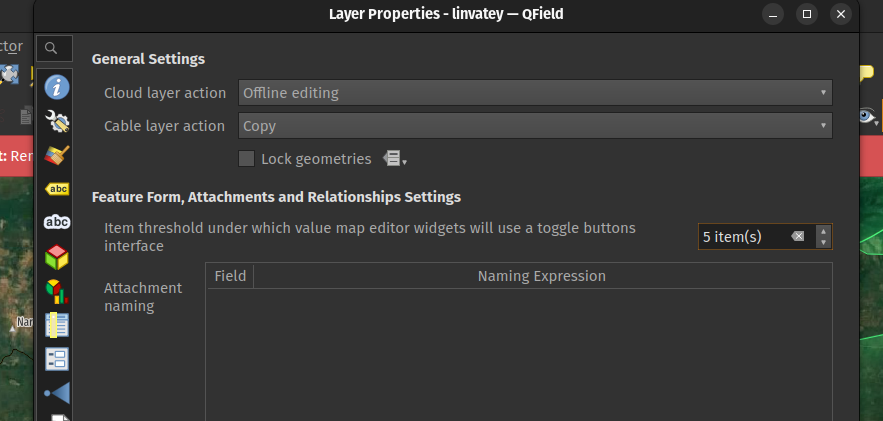

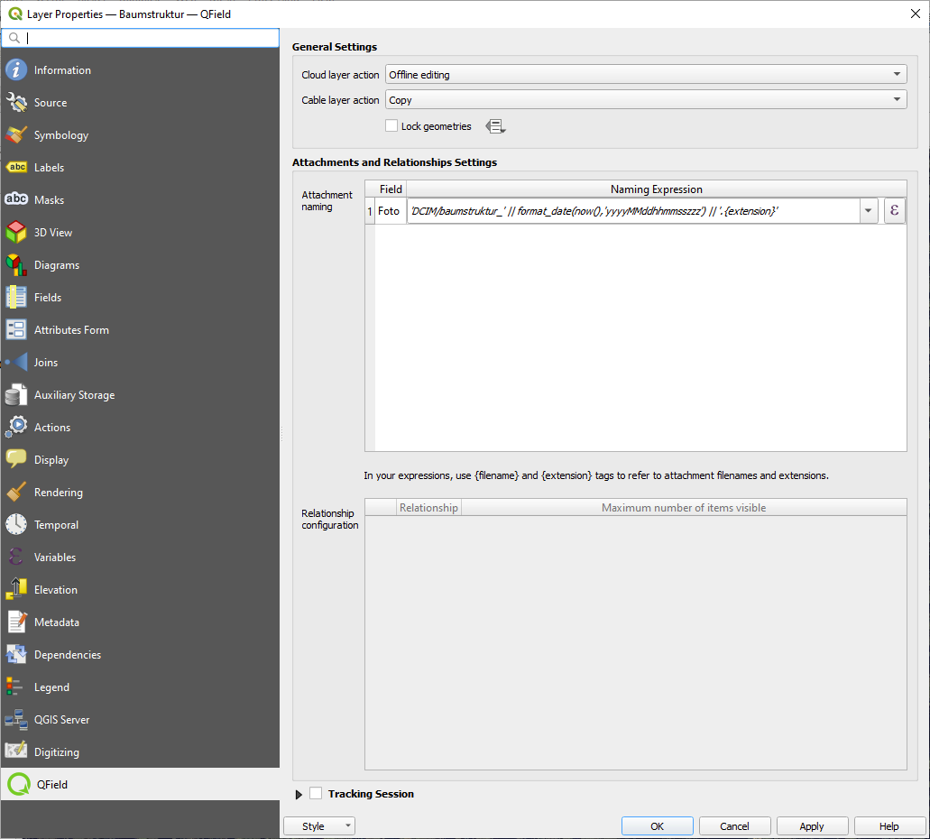

lorenzomorning , it’s a layer-wide setting, you’ll find it in the QField panel (provided you installed the QFieldSync plugin):

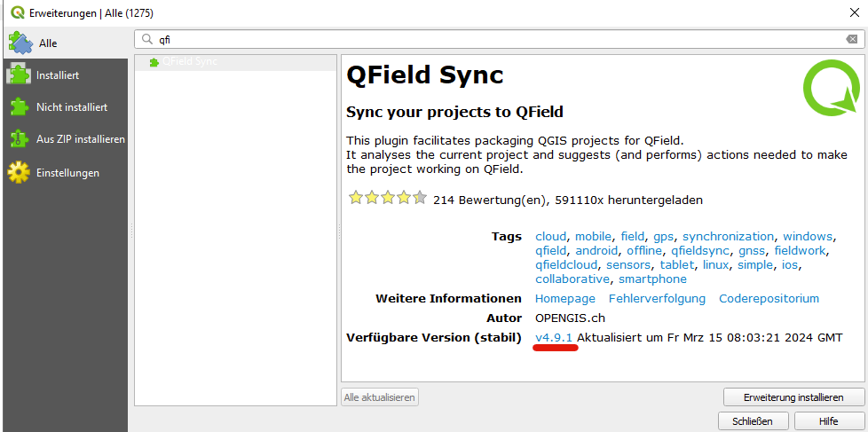

However, the newest version of QFieldSync that is available at my Plugin Manager in QGIS is v.4.9.1
But your release changelog of QFieldSync indicates that the configuration of the new toggle buttons is only available from v.4.10.0 on.
So must I install the newest version of the plugin via the source code from a .zip file or is the installation somehow directly accessble via the QGIS Plugin Manager?

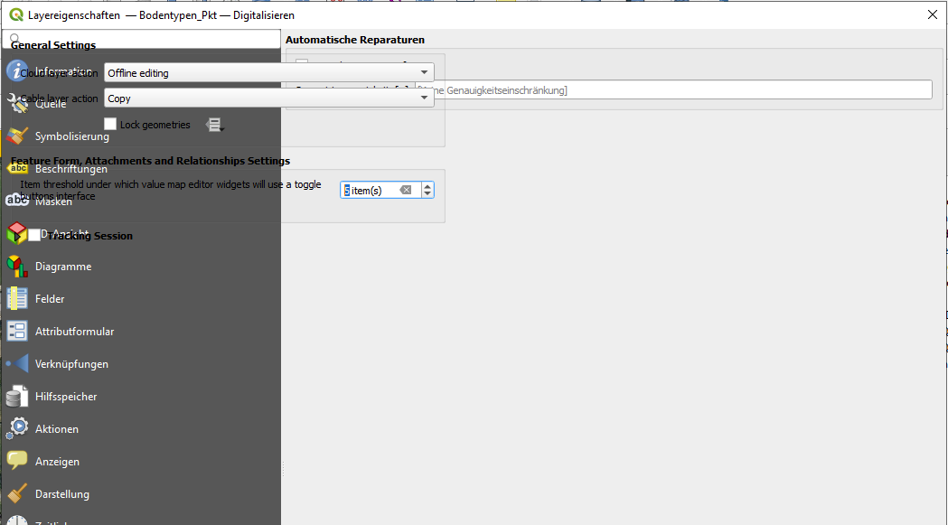

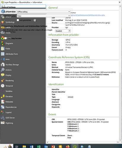

Note: When I install the v.4.10.0 from the .zip file provided on github, unfortunatley my layer properties look like the following:
with the following error message:
AttributeError: 'LayerSource' object has no attribute 'value_map_button_interface_threshold'

I uninstalled and reinstalled the plugin, but nothing changes in the user interface. As you can see there is no additional option to set the toggle buttons for a value map:
Imported from GitHub comment by @lorenzomorning on 2024-07-23T14:41:26Z

Hi SeqLaz,
I now tried both:
  1. Installing it from the plugins repository (4.9.1) obviously does not add any new layer control sections (see image above)
  2. Installing the zipped version 4.10.0 results in a kind of overlay for the QField layer settings (see image below, or post from 9th July). It now adds the option for controlling the toggle buttons of a value map, but unfortunately it is not nicely usable due the overlay…

Release of qfieldsync 4.10 has been delayed due to technical problems with the upload to the plugin registry, but has finally made it today. v4.10.1 is now available from the QGIS plugin repository and comes with this feature.
