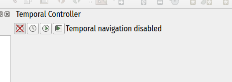

MathiasBaumgartinger , thanks for raising this, it was not the default behavior when we first introduced temporal filtering, and I’ve just pushed a commit for QField 3.6 that’ll get us back to a sane default :slight_smile:
Long story short, QField will not enable temporal filtering for temporal projects when the temporal navigation is disabled at the time the project was saved in QGIS, i.e.:
i.e.:
