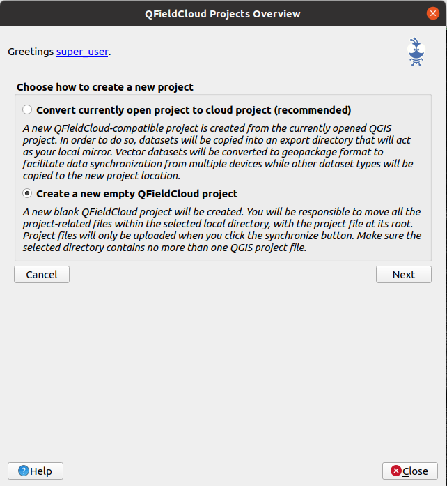

2.1) first when creating the project, select the latter option “create a new empty QFieldCloud project”:
2.2) syncrhonize your local project with the cloud. Make sure you PostGIS credentials are stored withing the .qgs/.qgz project file (read below) and that layer is marked as offline editing.
2.3) QFieldCloud will be able to sync with your original PostGIS now.
Note you might feel unconfortable to put your PG credentials in the project file, which is understandable. However, this is the only way to achieve it for now. In the next 3 months there will be a new functionality to store encrypted an .pgservice credentials on the cloud.
