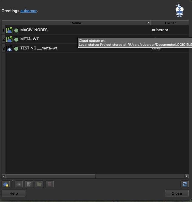

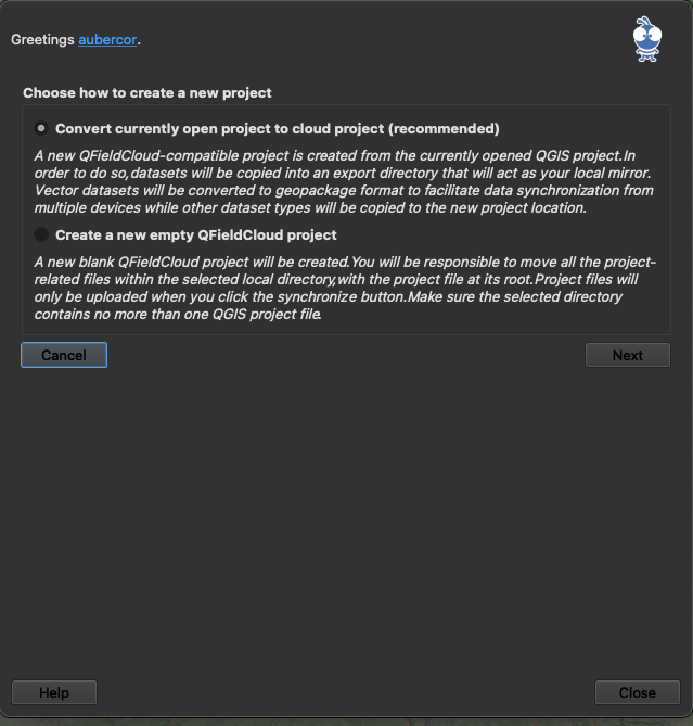

Do I have to re-create a new project by hitting the Qfield project button (blue cloud)?
I created the project using the first option: convert currently open project to cloud project

I tried to re-create the project for the Cloud and re-synchronize it to the cloud but nothing changed.
