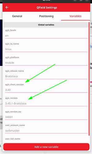

Similar situation with QField, you can check this information in the source code: https://github.com/opengisch/QField/blob/master/vcpkg/ports/qgis/portfile.cmake#L1-L2 . There it is actually easier to track what version you are running and when the QGIS version has been changed.
Imported from GitHub comment by @suricactus on 2024-12-04T09:05:03Z
Oh, my bad, you can see it in the variables tab:
Imported from GitHub comment by @suricactus on 2024-12-04T09:23:55Z
Oh dear, it is actually easy to find in QField. My bad, actually.
