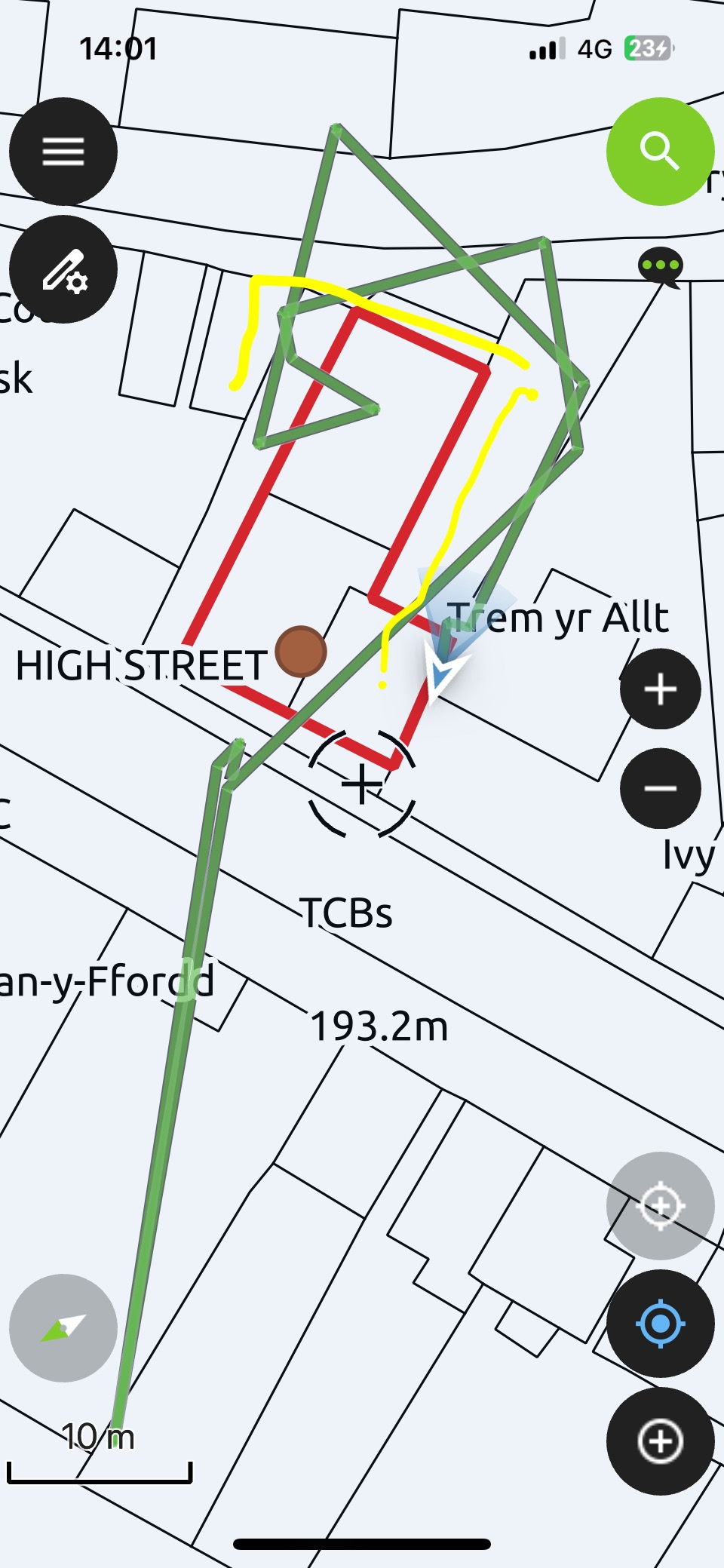

One of our QField users on iphone is experiencing some ‘tracking’ accuracy issues. Attached is a screenshot from his device the tracking line is in ‘green’ with the (actual) route in ‘yellow’. What might explain this? I’m not sure what model iphone it is.

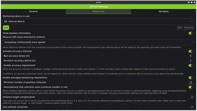

Hello shapley, you can improve the location accuracy by activating the Accuracy indicator and the Accuracy requirement in QField.
Also, for tracking, it is a good practice to set constraints on the track by specifying the minimum time and distance required for each vertice. For more details, please check the official documentation at this link: Tracking - QField Ecosystem Documentation
