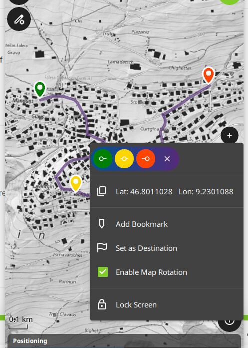

@V_Fa , once the plugin is installed and activated, you’ll find a new routing bar sitting at the very top of the map canvas menu here:
The map canvas menu can be trigger by long-pressing on the map canvas. The start/mid/end routing point will be added on top of the location you’ve long-pressed.

@Mathieu_Pellerin Your screenshot looks exactly like how i imagined the use of this plugin! So it would be wonderful if i could use it that way :heart_eyes:
Ah, that’s because you’re installing the wrong plugin :slight_smile: please install the QField OSRM routing plugin from the URL: https://github.com/opengisch/qfield-osrm/releases/download/v1.0/qfield-osrm-routing.zip
