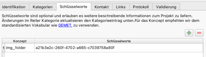

Hi there,
In qgis we can set custom metadata key at project level
Which reads in a qgs file as
... a21b3e2c-260f-4702-a665-c7039758a80f
My question is, can we access this from a app Extension (in qml)? I’ve searched through the header files but could not find anything about reading project metadata.
Many thanks!
Toni
