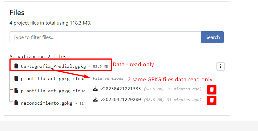

Hello kiri03,
We have the same problem, when we try to sync from cloud. We identify that every time that upload or sync from device Qfiled Cloud create a new file GPKG despite that layers in the GPKG are not edited or edited by any user.
We have tried all. We have created field UUID´s, . When we try to sync in Qgis the plugin download a new read-only file everey time. We need urgent help, if someone know how to fix that… I appreciate your help
Imported from GitHub comment by @gisDS on 2023-04-21T22:41:28Z
This is likely due to how QGIS save GPKG files. Every time you open a project and close it the GPKG files are updated whether or not there are any changes. I just manually uncheck the files every time when I don’t make any changes to keep from having multiple versions on the cloud.
