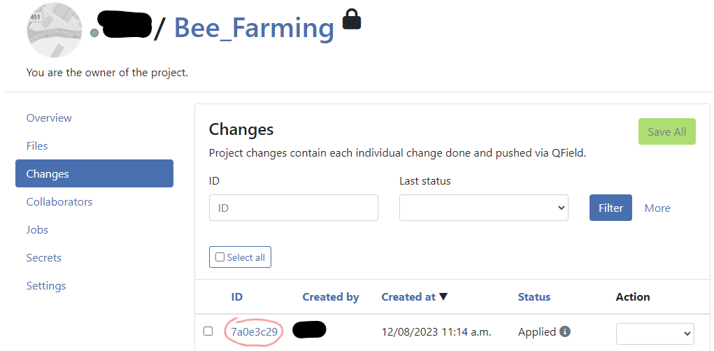

Hello, I’m new to using QField and I’m building a model to collect data from the field to improve the city’s water network. The problem is that the first time I tested the app on my smartphone, the changes I made appeared in the changes menu on the website with a preview on the map that helped me find where the changes were made. However, now they don’t appear anymore when I click on the change ID. Is this feature discontinued? If yes, there’s a way to help me find the location on where the changes were made?
Imported from GitHub discussion by @wesleyhuck on 2023-12-26T20:00:28Z
Are you talking about the qfield.cloud site and the changes ID circled in red?

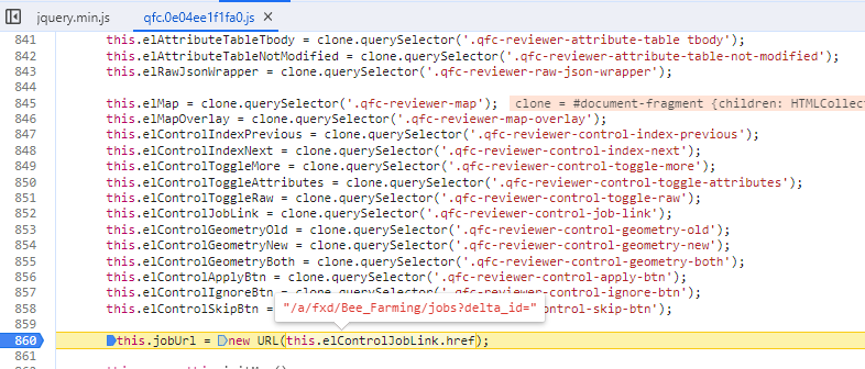

Try another browser. It seems that since at least a few weeks ago, opening this popup does not work anymore in Chrome (tried with current version120.0.6099.130), since the relative URL (from “href” property) is missing its base.
jquery.min.js:2 Uncaught TypeError: Failed to construct 'URL': Invalid URL
at new Reviewer (qfc.0e04ee1f1fa0.js:860:21)
at qfc.0e04ee1f1fa0.js:1381:22
at HTMLDocument.<anonymous> (qfc.0e04ee1f1fa0.js:1453:5)
at e (jquery.min.js:2:30038)
at t (jquery.min.js:2:30340)
Firefox works, though.

That’s exactly what I needed. I switched to Firefox and it works perfectly now. Thank you for your help!
