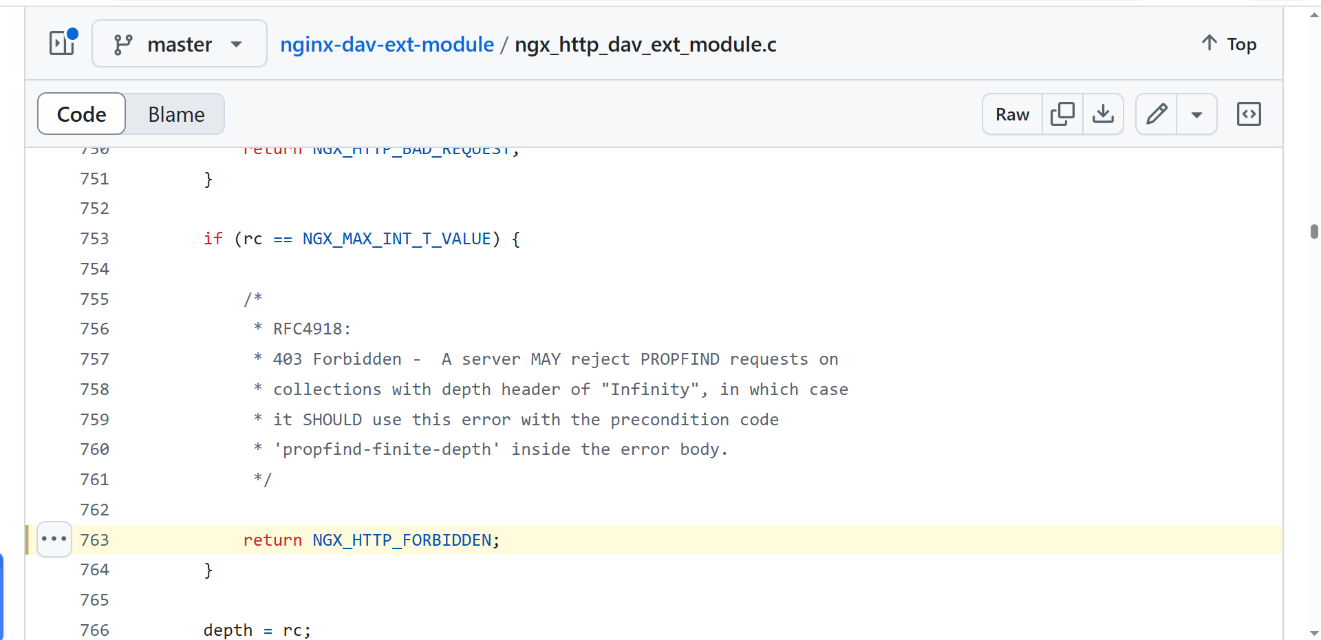

After searching for 403 error within the logic of my nginx webdav module, I figure out why.

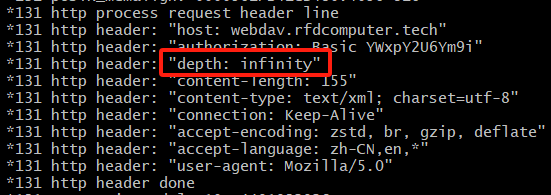

The module would return 403 for webdav request having a header of “depth: infinity”. And that’s what exactly qfield’s webdav request brings currently. This is the debug log of nginx for the qfield’s webdav request.

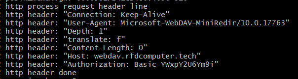

A reference to the Windows Explorer’s webdav request:
Now I could finally access the requested webdav folder in qfield.
