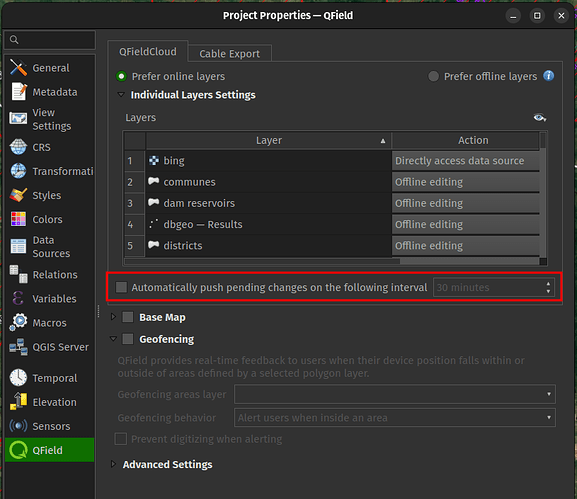

RatInTheField , good news, the automated regular push of changes to QFieldCloud has been implemented for a while now (since QField 3.2.0). You can enable this functionality and set the push interval in the QField panel when configuring your project with qfieldsync plugin:

Hi Mattieu,
Thanks for getting back to me. I think that I did not explain myself well
enough. I am aware of the ability to automate the push function to
QFieldCloud, but would like to be able to automate the Send To function
accessed from QField Menu>Cog>Project Folder>3 dots >‘Send to’ without using
QFieldCloud.
I want to be able to send files to a remote location managed by another app
such as FV File Explorer so that I can send data to my own SSH protected
server. While this is currently possible as an ad-hoc function, repeating
the action many times a day would be boring and risk errors, so I was hoping
that it would be possible to automate and schedule the Send To function to
speed my workflow.
Is this possible? Could it be within your design scope?

RatInTheField I assume this should be doable with a plugin, calling platformUtilities.sendCompressedFolderTo(qgisProject.homePath) at regular intervals or a prominent button.
