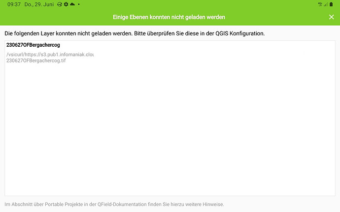

I tried arrount with COG in the cloud a bit. A Layer without auth. works in QField on my mac desktop, but on the Android tablet the error (picture) comes. So my first intention was to ask here what is possible and implemented in QField?

EulenspiegelTill , we fixed an issue on Android which unlocked this very functionality. You can confirm it works using an APK provided here: Package CAs for curl by nirvn · Pull Request #4415 · opengisch/QField · GitHub

Work’s perfect! I will try arround a bit with compression and see whats working smooth. Also try out authentification (enviroment variables
