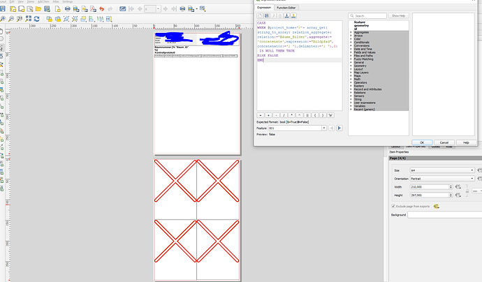

I have the same set up like you described: Pictures are in a 1:n related table. For my use case i decided it is enough to print 4 pictures of a parent feature. This is how i set it up:
  1. Created a page with 4 raster image canvases. On page properties of the “picture page” i checked the box Exclude page from exports and added an expression so the page is not printed if there are no pictures:
CASE
WHEN project_home+'/'+ array_get( string_to_array( relation_aggregate(relation:='relation_name',aggregate:='concatenate',expression:="fieldname_of_your_picture_path",concatenator:='; '),delimiter:='; '),0) IS NULL THEN TRUE
ELSE FALSE
END
  1. For the raster images i set an data defined override with following expression:
project_home+'/'+ array_get( string_to_array( relation_aggregate(relation:='Bäume_Bilder',aggregate:='concatenate',expression:="Bildpfad",concatenator:='; '),delimiter:='; '),0)
Note: the ‘0’ in the end of the expression takes the first picture child feature (picture) into account. You need to change it to 1-3 for each of the other raster images.
This works fine in QField :slight_smile:
