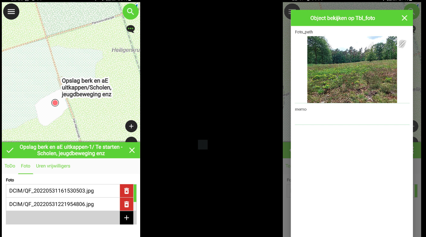

In the (mobile) project it must be possible to add different photos to one feature.

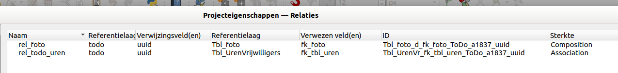

Because of that, there are two tables: 1/ geometry layer with the features (todo) and 2/ another layer without geometry but with a list of pictures (tbl_foto).
For details, see the manual for QField: Pictures - QField Ecosystem Documentation
The one to many relation (rel_foto) was set and is functioning.
In the mobile QField application the pictures are saved and visible. The photos are also visible in the QGis desktop project when opening the attribute widget form (drag and drop).

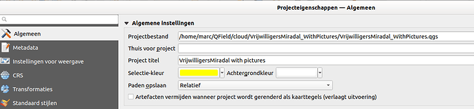

2/ Because the project doesn’t have a project_home set (it is not compatible with syncing over QField Cloud), I created a virtual field “project_home” in the geometry table (todo)
3/ When a photo is taken, the name and path of the photo is stored in the no geometry layer (tbl_foto) and the field “path”.
As far as I understand, the html code in Maptips should point to the project_home and the field “path” where the photos are stored.
But since I don’t have the project_home set in the project the alternative is pointing out to a virtual field where the project_home variable is stored, in my case the field “project_home” (see purple printscreen above). So I tried the following
