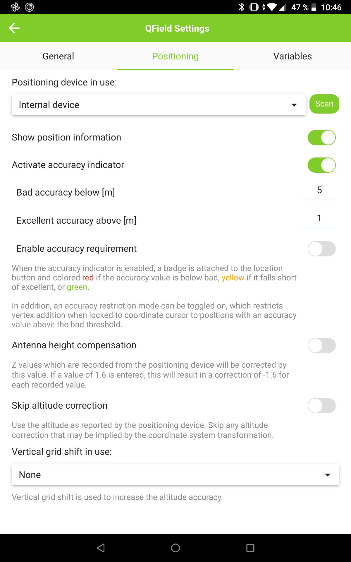

cz-ranger , can you attach a screenshot of your positioning settings panel?
Ie:
Imported from GitHub comment by @nirvn on 2021-10-12T15:04:54Z

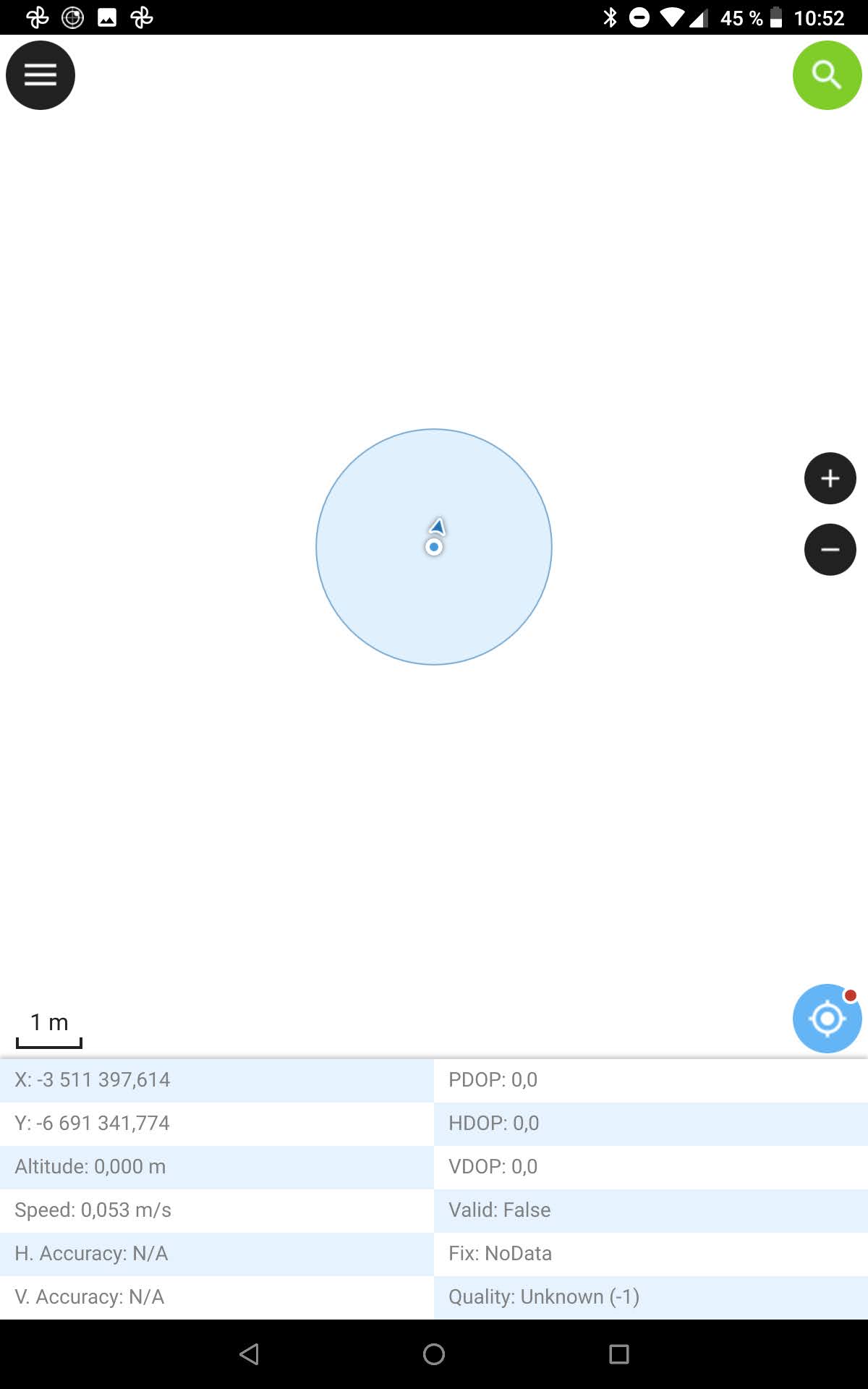

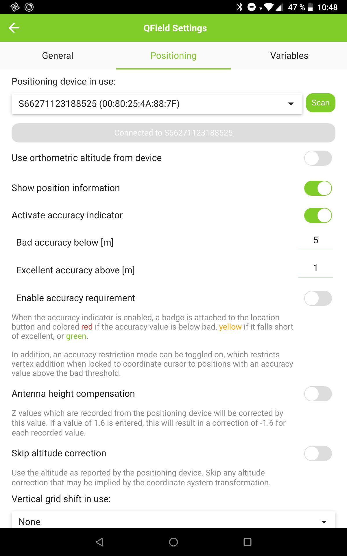

This is the positioning setting using directly connected to GPS via Bluetooth (location totally off)

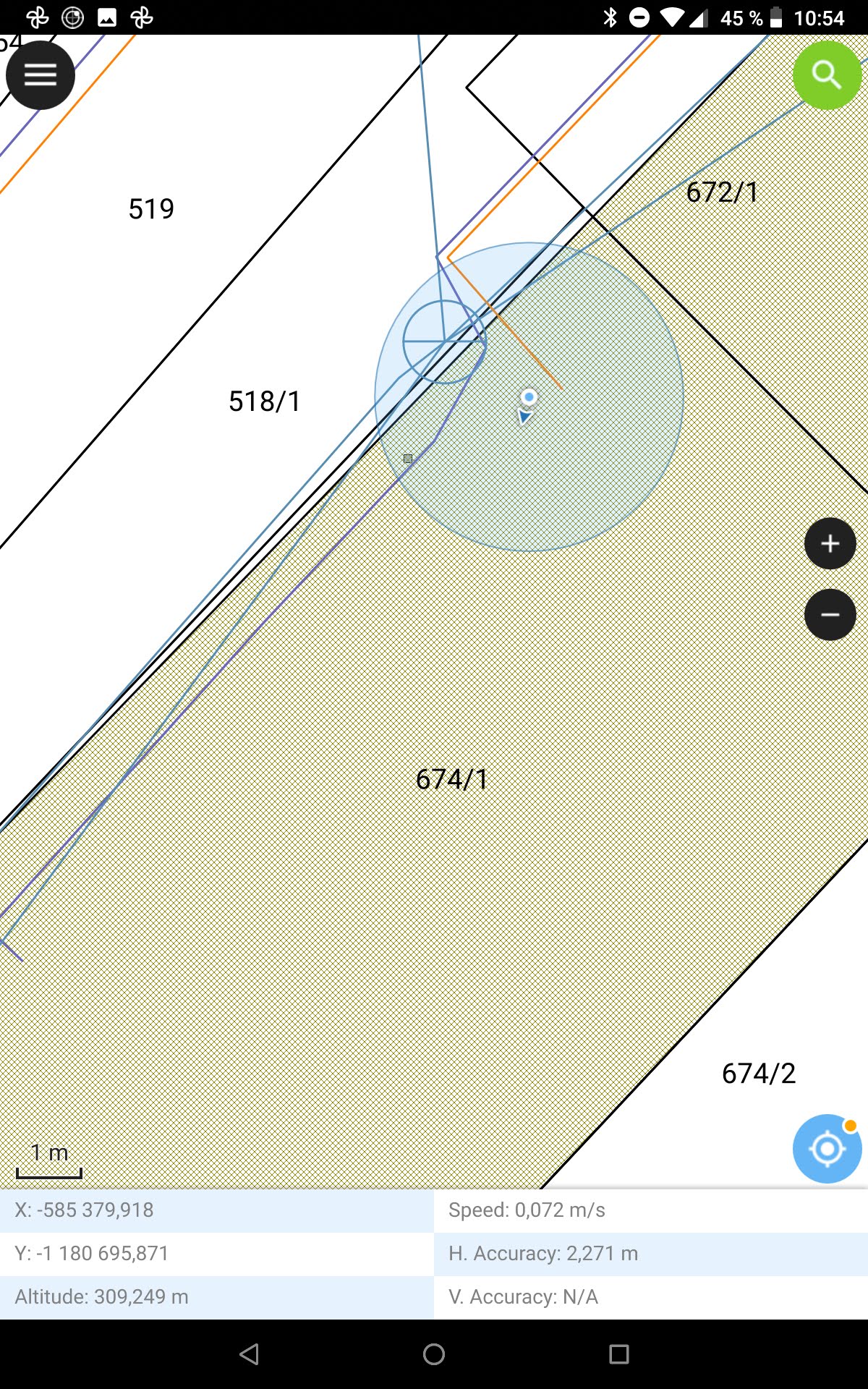

This is the position setting when using mock location via native app from South (LBS Manage). This works, but the position is consistently about 1m off in both x and y. This problem is exclusive to Qfield, in other mapping apps the location appears to be correct.

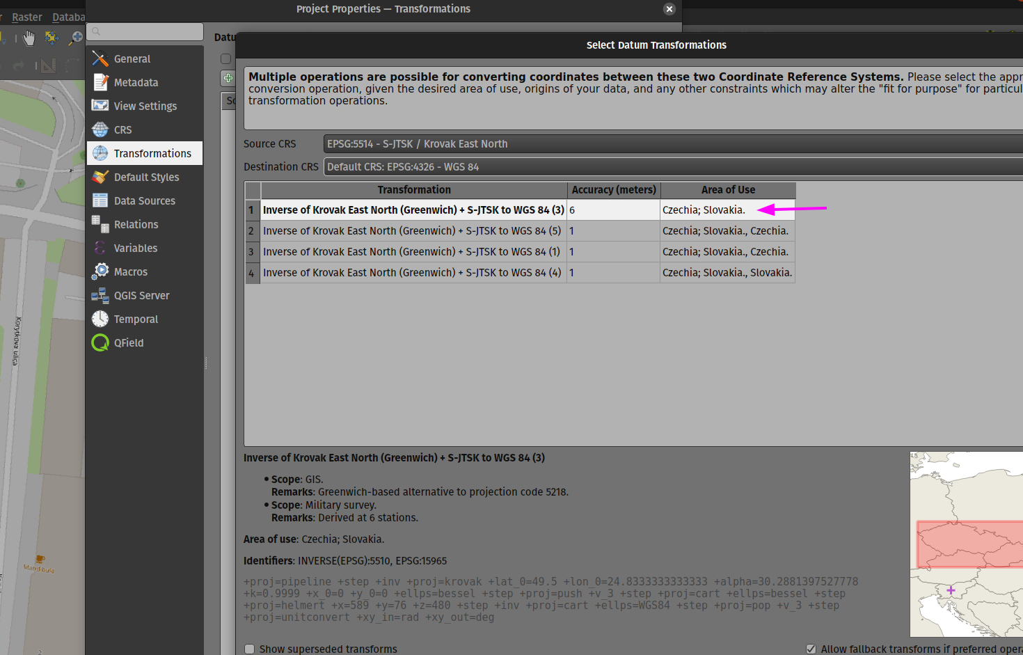

cz-ranger , I did a couple of tests locally. It could well be that your project’s datum transformations settings aren’t properly set.
If you open your project on QGIS and open the project properties’ transformation panel, you can add/edit the transformation maths used to go to/from EPSG:5514 to EPSG:4236 (WGS84, the position’s coordinates projection).
This transformation worked for me:
While the other ones would have test points not align as expected.
I suggest you give this a try. Also, give QField 2.0 beta 8 a try if you haven’t yet.
