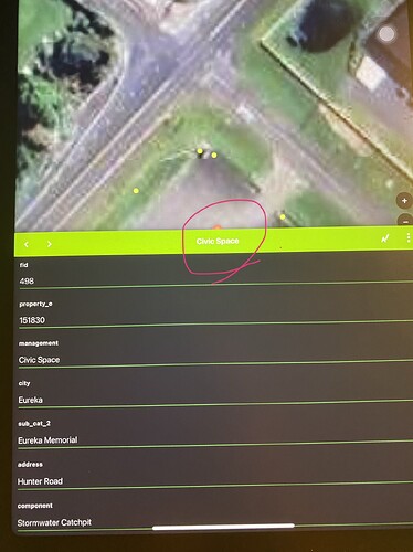

How to change displayed feature name from the attribute form in QField?
In the picture, how can I change the wards in the circle to the ones I want from my attribute table/form? It feels like they’re chosen randomly, isn’t it? Because when I create another project, they show up differently, even though the format of the attribute form is the same.
I think to get what you want, in your QGIS project you can open the layer’s Properties and go to the Display tab. From there, you can either pick the field you want to show or use an expression instead.
Hi Both,
Yes that is right to change them you do this via the display function.
