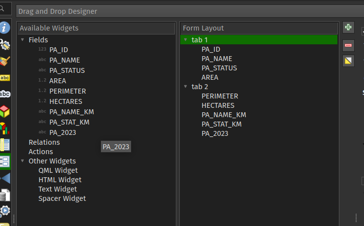

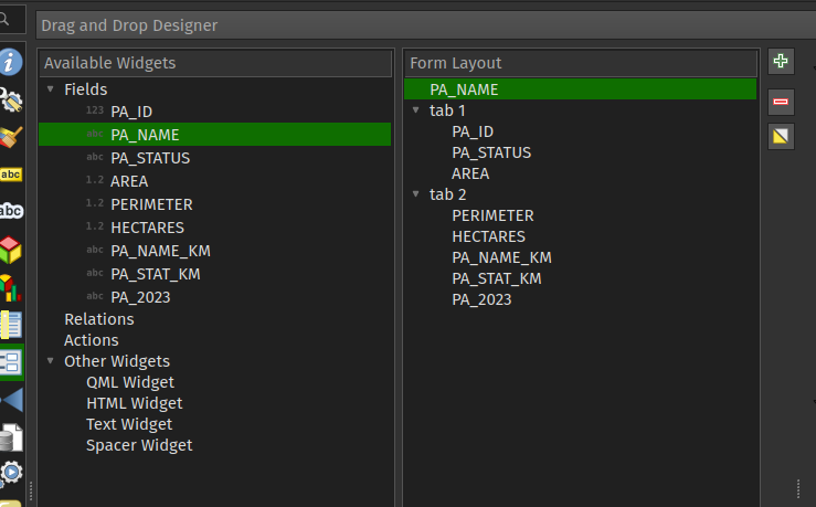

Kaguenze , when you design your feature form layout with tabs, you have to make sure the root elements are only containers, otherwise QField will flatten everything into a tab-less list.
E.g., this will work:
While this will not work and will result in a single list of all items:
