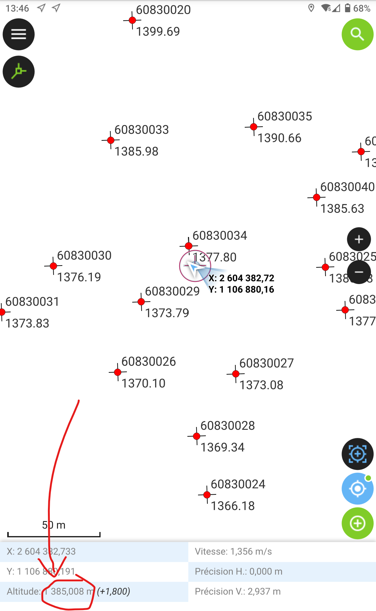

On the other hand, I cannot retrieve the corrected altitude which is
displayed on the Qfield coordinate tracking. If I use for the altitude Z
the variable/z($geometry)/, I have a “Null” value. If I use
/z(position_coordinate)/ I have the altitude relative to the Ellipsoid
in WGS 84.
My problem is to be able to retrieve the altitude corrected by Qfield
and which is displayed in the field on my image.
In which variable is this displayed value stored?
And how can I assign it to fields in my form prepared on Qgis?
