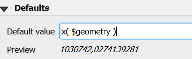

  2. Under ‘properties’ → attribute form (change to second option - Drag and Drop Designer)
  3. Remove the x, y, z from your attribute form → in the ‘available widgets’ field direct to
  4. x coordinate and add x( $geometry ) to the ‘Defaults tab’
  5. Do the same for y and z

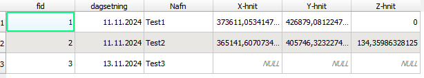

Hi! and thank you for answering. Yes, so I have actually done this for the x, y and z fields I have made. But what I am wondering is that when I am testing it out in QField on my tablet and I make a new measurement, and then sync it and look at the attribute table on my desktop all the fields show a NULL value
like on the picture, the first two points I made I had to manually add the coordinates with the field calculator, and the newest point(Test3) which has the attribute for just like you show just shows NULL values. I am just wondering if there is a way to make this more automated, so when I sync the new measurements that the coordinates are automatically there when i look at the attribute table on the desktop.

Are you sure the coordinate curser is locked to position? This is now found on the circle menu. You will not get your x,y,z coordinates otherwise.
Howie
