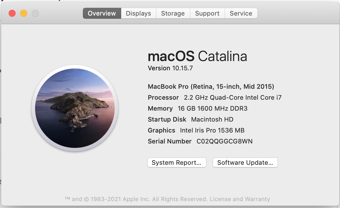

Photo Synchronization(Can't find photos after synchronization)
I am using a Mac
On Tue, Mar 29, 2022 at 11:18 AM juwizeye @.***> wrote:
what OS are you using ?

but the devices are android lenovo - could there be a compatibility issue
Imported from GitHub comment by @enheduanna on 2022-03-29T15:25:20Z
perhaps that is (macOS) the reason why you don’t have .qfieldcloud folder. Me i am using windows. for compatibility with android lenovo, I don’t know.

Mac may have the *nix way of interpreting paths, and file-/dirnames starting with a dot like .qfieldcloud there are hidden, you need to enable something like view hidden files in GUI, or use ls -a in a terminal/bash…
