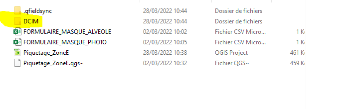

I think that relative to project path is the best solution. It will add DCIM folder in your projet path.

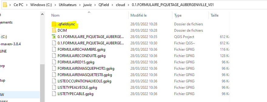

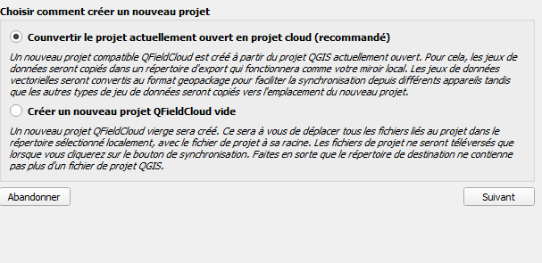

how do you create your Qfield cloud project?
there are two ways and the folder of your project will change depending on the way that you are using. If you choose the first one it will create a new folder under C:\Users\username\QField\cloud.
Imported from GitHub comment by @juwizeye on 2022-03-29T14:53:35Z
Yes, I use the option that is selected in your image.
Imported from GitHub comment by @enheduanna on 2022-03-29T14:55:44Z

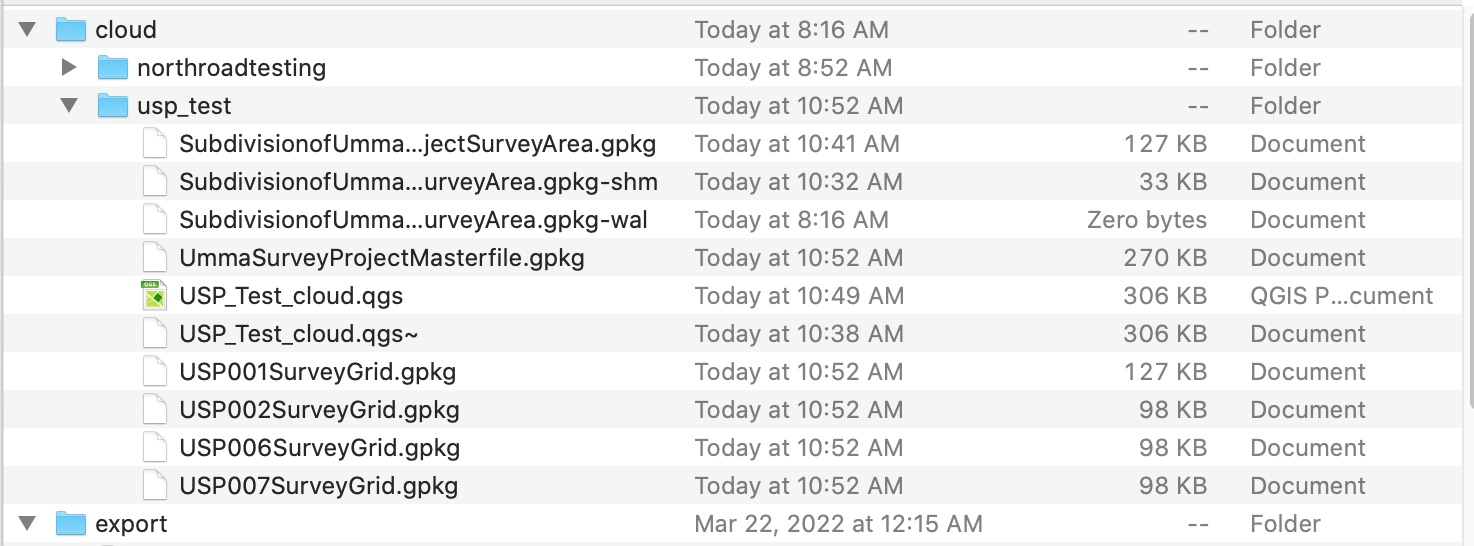

so you should go in C:\Users\yourusername\QField\cloud to see if your projet is not duplicated there.
Imported from GitHub comment by @juwizeye on 2022-03-29T15:06:13Z
Imported from GitHub comment by @enheduanna on 2022-03-29T15:08:58Z
is teh USP_Test_Cloud.qps with the little wiggle at the end a duplication?
Imported from GitHub comment by @enheduanna on 2022-03-29T15:09:34Z
you should normally have a folder which is called .qfieldsync
have you try to see if other modifications that you are doing on Qfield are being done also in your Qgis projet?
Imported from GitHub comment by @juwizeye on 2022-03-29T15:17:27Z
