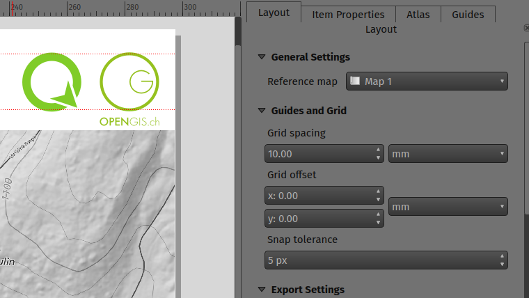

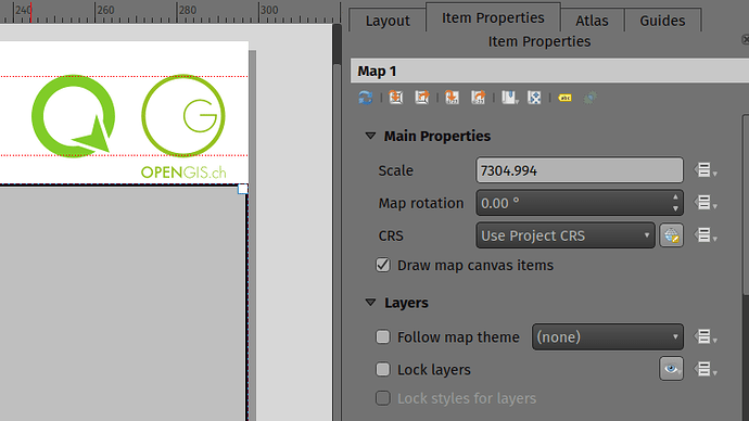

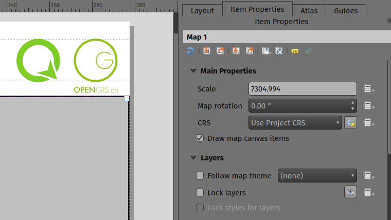

martingeh , gut feeling: your layout map item CRS doesn’t match that of the project. You can check this here in your layout:
Also, make sure your reference map is set to your main map item that you want driven by QField:

Thankyou very much nirvn! Such a simple thing that I didn’t check. That works as expected.
