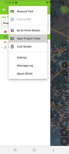

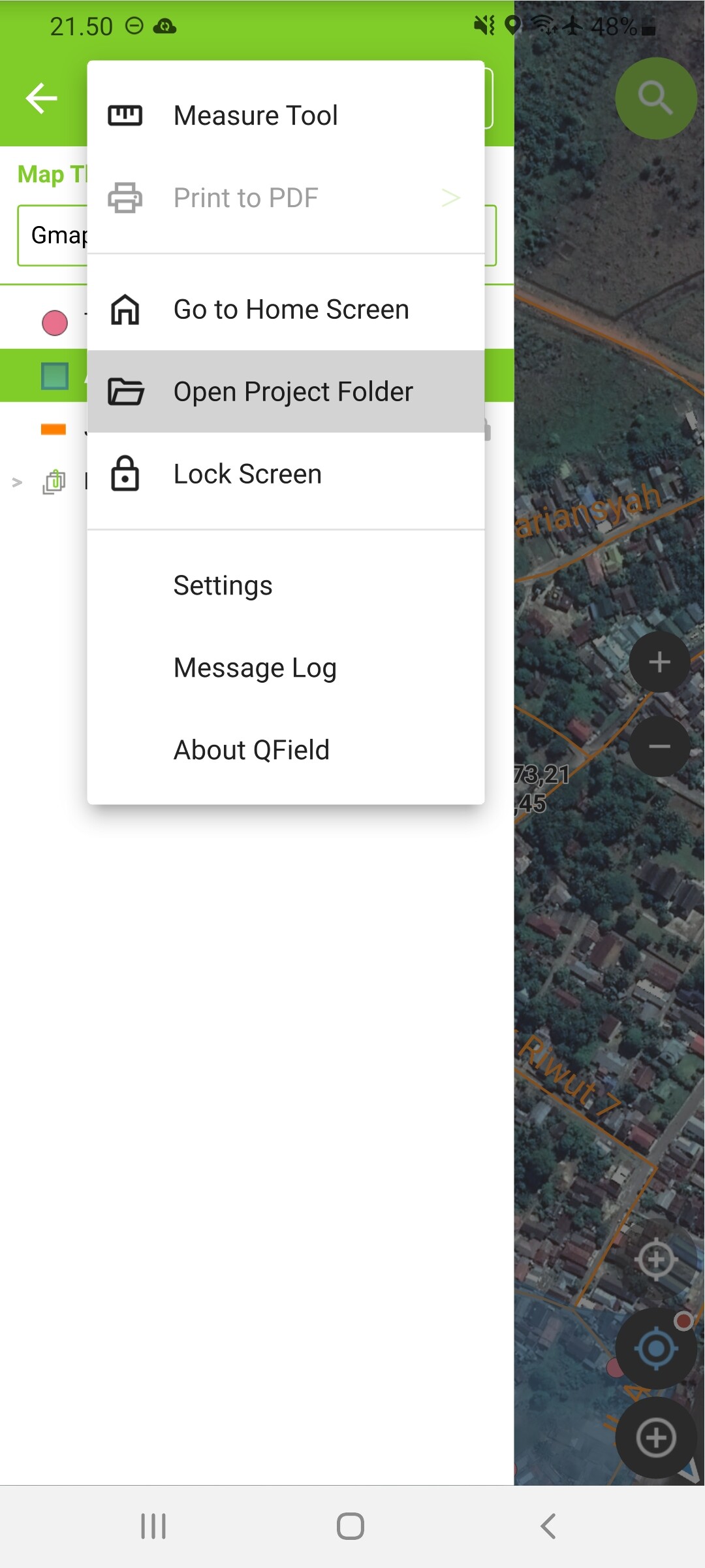

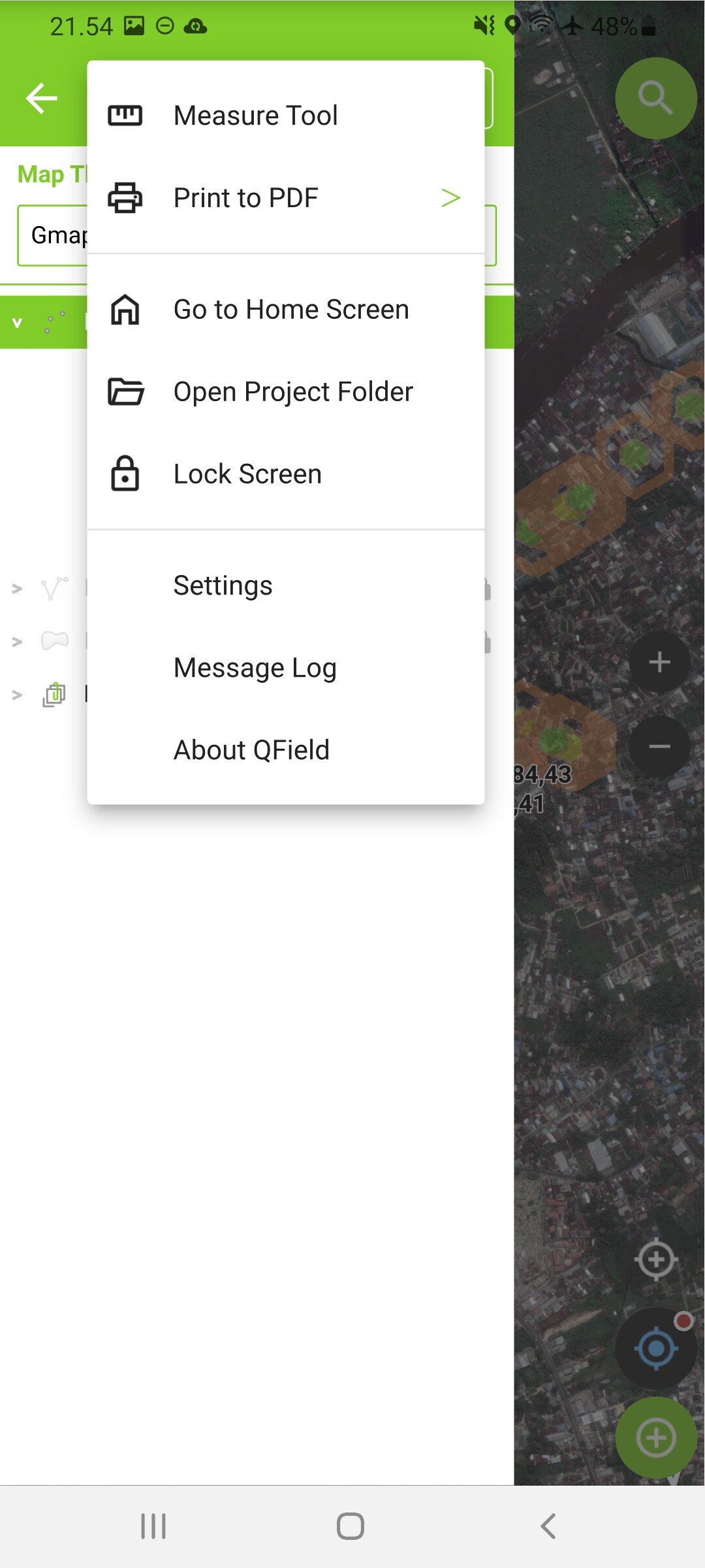

I have android version 11, installed qfield 2.5.3, and have 2 project exercise with qgis 2.28, but just one project can use menu printing to pdf that file save in qgis v 3.28
Is there anything wrong with, or anything suggest for me, thanks a lot

Indiok , please attach those two sample projects, it’ll facilitate debugging.

Indiok , your Peta Banjir latihan_cloud.qgs project has no layout, so you will so no layout in QField
Proof:
