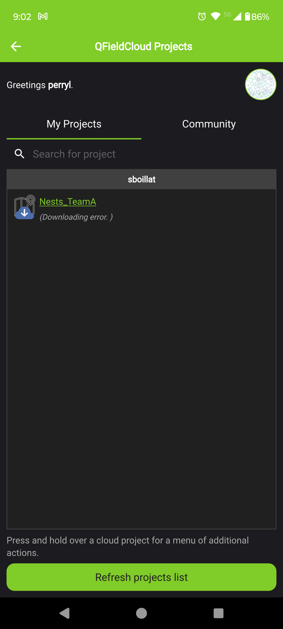

QField app. Project download stops at 22%
I have created a project on QFieldCloud (latest version of QField Cloud, QGIS 3.34.4 LTR) , with about 25 collaborators with reporter rights. Some of them (about 50%) cannot download the project with the QField app on their mobiles. Download systematically stops at 22%. Any explanation/solution for this? Thank you for your collaboration.
