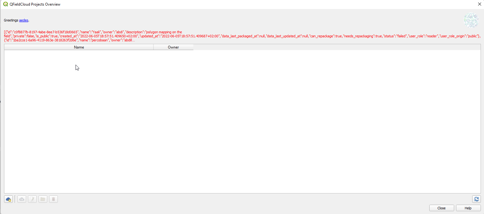

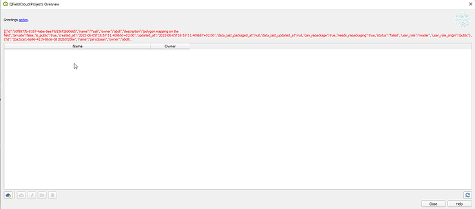

Hey all,
today after a failed synchronisation all of my QField Sync projects disappeared from the overview. They are still accessible through the online login portal.
I have tried:
Reinstalling the plugin
Reinstalling QGis
Logging in and out of the account
Using another computer
What else can I do? The error code seems more confusing than helpfull as well…

I have this same problem :confused: [{“id”:“c0f8877b-8197-4abe-8ee7-b536f18d0665”,“name”:“Yaali”,“owner”:“abdi”,“description”:“polygon mapping on the field”,“private”:false,“is_public”:true,“created_at”:“2022-06-05T18:57:51.409650+02:00”,“updated_at”:“2022-06-05T18:57:51.409687+02:00”,“data_last_packaged_at”:null,“data_last_updated_at”:null,“can_repackage”:true,“needs_repackaging”:true,“status”:“failed”,“user_role”:“reader”,“user_role_origin”:“public”},{“id”:“1ba2cce1-6a96-4119-863e-3818263f2d6e”,“name”:“percobaan”,“owner”:"abdill…
In web and QGIS everything is fine but on QField I can’t sync project (getting 3 dots on bottom)

For about 1,5 h. Problem on every mobile account of my collaborators. In qfield log there is information about bad connection.
[HTTP/200] https://app.qfield.cloud/api/v1/projects/?include-public=true Błąd sieci.[{“id”:“c0f8877b-8197-4abe-8ee7-b536f18d0665”,“name”:“Yaali”,“owner”:“abdi”,“description”:“polygon mapping on the field”,“private”:false,“is_public”:true,“created_at”:“2022-06-05T18:57:51.409650+02:00
[{“id”:“c0f8877b-8197-4abe-8ee7-b536f18d0665”,“name”:“Yaali”,“owner”:“abdi”,“description”:“polygon mapping on the field”,“private”:false,“is_public”:true,“created_at”:“2022-06-05T18:57:51.409650+02:00”,“updated_at”:“2022-06-05T18:57:51.409687+02:00”,“data_last_packaged_at”:null,“data_last_updated_at”:null,“can_repackage”:true,“needs_repackaging”:true,“status”:“failed”,“user_role”:“reader”,“user_role_origin”:“public”},{“id”:“1ba2cce1-6a96-4119-863e-3818263f2d6e”,“name”:“percobaan”,“owner”:“abdillah”,“description”:”“,“private”:false,“is_public”:true,“created_at”:“2022-06-27T03:30:23.383221+02:00”,“updated_at”:“2022-08-04T18:09:20.432704+02:00”,“data_last_packaged_at”:“2022-08-04T18:09:07.369279+02:00”,“data_last_updated_at”:null,“can_repackage”:true,“needs_repackaging”:true,“status”:“ok”,“user_role”:“reader”,“user_role_origin”:“public”},{“id”:“0f50af1f-e7ef-40ba-a893-273a6d7f87fb”,“name”:“FTTH”,“owner”:“abdulrahman”,“description”:“Abd”,“private”:false,“is_public”:true,“created_at”:“2022-04-24T22:36:16.890837+02:00”,“updated_at”:“2022-04-24T22:36:16.890905+02:00”,“data_last_packaged_at”:null,“data_last_updated_at”:null,“can_repackage”:true,“needs_repackaging”:true,“status”:“failed”,“user_role”:“reader”,“user_role_origin”:“public”},{“id”:“173ac4f5-f9e1-4645-a7cc-bdb6a8c6f02f”,“name”:“ResourceMappinng”,“owner”:“abebe”,“description”:“Natural Resource and Mobility Route Mapping in Pastoral Areas of Ethiopia”,“private”:false,“is_public”:true,“created_at”:“2021-12-19T23:08:57.150848+01:00”,“updated_at”:“2022-08-04T14:01:55.435230+02:00”,“data_last_packaged_at”:“2022-08-04T14:00:04.880618+02:00”,“data_last_updated_at”:null,“can_repackage”:true,“needs_repackaging”:true,“status”:“ok”,“user_role”:“reader”,“user_role_origin”:“public”},{“id”:“d8a944e6-4a94-43a4-8344-31f594083945”,“name”:“75itapibge”,“owner”:“abimael”,“description”:“Mapeamento”,“private”:false,“is_public”:true,“created_at”:“2022-06-10T15:12:24.802033+02:00”,“updated_at”:“2022-08-04T14:04:07.980339+02:00”,“data_last_packaged_at”:“2022-08-04T14:03:58.552313+02:00”,“data_last_updated_at”:null,“can_repackage”:true,“needs_repackaging”:true,“status”:“ok”,“user_role”:“reader”,“user_role_origin”:“public”},{“id”:“dd488f9c-f3a4-4c75-9e0d-a820a979a75f”,“name”:“Albert”,“owner”:“abn”,“description”:”“,“private”:false,“is_public”:true,“created_at”:“2022-05-23T12:15:27.097573+02:00”,“updated_at”:“2022-07-13T17:08:51.064693+02:00”,“data_last_packaged_at”:“2022-07-13T17:08:41.252810+02:00”,“data_last_updated_at”:null,“can_repackage”:true,“needs_repackaging”:true,“status”:“ok”,“user_role”:“reader”,“user_role_origin”:“public”},{“id”:“f0490fc7-6c1b-4a89-9d79-a7cb3501f610”,“name”:“RS8”,“owner”:“abubakr”,“description”:“Geol.”,“private”:false,“is_public”:true,“created_at”:“2022-05-09T16:10:36.605775+02:00”,“updated_at”:“2022-05-09T16:10:36.605817+02:00”,“data_last_packaged_at”:null,“data_last_updated_at”:null,“can_repackage”:true,“needs_repackaging”:true,“status”:“failed”,“user_role”:“reader”,“user_role_origin”:“public”},{“id”:“7b2c0499-4535-4a8c-8c31-ca4b7ae80508”,“name”:“webmap”,“owner”:“accelerator”,“description”:”“,“private”:false,“is_public”:true,“created_at”:“2022-06-10T18:32:12.493915+02:00”,“updated_at”:“2022-07-30T15:20:39.749934+02:00”,“data_last_packaged_at”:“2022-07-30T15:20:32.415254+02:00”,“data_last_updated_at”:null,“can_repackage”:true,“needs_repackaging”:true,“status”:“ok”,“user_role”:“reader”,“user_role_origin”:“public”},{“id”:“e9075172-d4f1-44f9-a673-936d96d5f202”,“name”:“Adib83”,“owner”:“adib83”,“description”:“Lengkuas”,“private”:false,“is_public”:true,“created_at”:“2022-05-10T07:43:34.760272+02:00”,“updated_at”:“2022-08-02T21:04:47.116136+02:00”,“data_last_packaged_at”:“2022-08-02T21:04:38.191782+02:00”,“data_last_updated_at”:null,“can_repackage”:true,“needs_repackaging”:true,“status”:“ok”,“user_role”:“reader”,“user_role_origin”:“public”},{“id”:“87dded0c-384a-4b88-8b5e-d144d0e5fd86”,“name”:“Cholestan”,“owner”:“adnan”,“description”:”“,“private”:false,“is_public”:true,“created_at”:“2022-06-23T19:36:27.623512+02:00”,“updated_at”:“2022-07-20T17:03:48.133102+02:00”,“data_last_packaged_at”:“2022-07-20T17:02:26.125429+02:00”,“data_last_updated_at”:null,“can_repackage”:true,“needs_repackaging”:true,“status”:“ok”,“user_role”:“reader”,“user_role_origin”:“public”},{“id”:“fb0379ab-4a43-41c2-b943-6a76fddd40af”,“name”:“Cholestan12345”,“owner”:“adnan”,“description”:”“,“private”:false,“is_public”:true,“created_at”:“2022-06-23T19:37:55.858761+02:00”,“updated_at”:“2022-06-23T19:38:53.713160+02:00”,“data_last_packaged_at”:null,“data_last_updated_at”:null,“can_repackage”:true,“needs_repackaging”:true,“status”:“ok”,“user_role”:“reader”,“user_role_origin”:“public”},{“id”:“585c03f3-6b91-4c38-b7e6-d42067ba1623”,“name”:“NationalGrid”,“owner”:“adriancruz20”,“description”:”“,“private”:false,“is_public”:true,“created_at”:“2022-06-10T09:55:02.275945+02:00”,“updated_at”:“2022-06-29T15:08:22.202954+02:00”,“data_last_packaged_at”:“2022-06-29T15:08:13.945485+02:00”,“data_last_updated_at”:null,“can_repackage”:true,“needs_repackaging”:true,“status”:“ok”,“user_role”:“reader”,“user_role_origin”:“public”},{“id”:“2c263743-86e9-476b-8021-2fc38feddb6b”,“name”:“natlgrid”,“owner”:“adriancruz20”,“description”:”“,“private”:false,“is_public”:true,“created_at”:“2022-06-10T09:55:33.837815+02:00”,“updated_at”:“2022-06-10T09:56:33.396392+02:00”,“data_last_packaged_at”:null,“data_last_updated_at”:null,“can_repackage”:true,“needs_repackaging”:true,“status”:“ok”,“user_role”:“reader”,“user_role_origin”:“public”},{“id”:“14e9e467-43fb-448c-8c73-b57aa1c78c1d”,“name”:“NatlGrid”,“owner”:“adriancruz20”,“description”:”“,“private”:false,“is_public”:true,“created_at”:“2022-06-10T09:55:26.188548+02:00”,“updated_at”:“2022-07-17T08:40:41.459138+02:00”,“data_last_packaged_at”:“2022-07-17T08:40:33.528340+02:00”,“data_last_updated_at”:null,“can_repackage”:true,“needs_repackaging”:true,“status”:“ok”,“user_role”:“reader”,“user_role_origin”:“public”},{“id”:“0ba2f689-fb04-4d9e-a7ea-d01309ce007c”,“name”:“Boomvalk_Den_Haag_2022”,“owner”:“adri_clements”,“description”:”“,“private”:false,“is_public”:true,“created_at”:“2022-04-06T08:52:51.659859+02:00”,“updated_at”:“2022-07-24T03:30:39.606020+02:00”,“data_last_packaged_at”:“2022-07-24T03:30:25.570986+02:00”,“data_last_updated_at”:null,“can_repackage”:true,“needs_repackaging”:true,“status”:“ok”,“user_role”:“reader”,“user_role_origin”:“public”},{“id”:“8451030d-27fb-4b4c-a3ad-e9850ca2f0f7”,“name”:“Sachin”,“owner”:“adwallz”,“description”:”“,“private”:false,“is_public”:true,“created_at”:“2022-06-29T07:58:56.530818+02:00”,“updated_at”:“2022-07-10T10:21:03.854951+02:00”,“data_last_packaged_at”:“2022-07-10T10:20:50.138465+02:00”,“data_last_updated_at”:null,“can_repackage”:true,“needs_repackaging”:true,“status”:“ok”,“user_role”:“reader”,“user_role_origin”:“public”},{“id”:“c2171319-542d-4c1d-9d51-4fd177ff237a”,“name”:“erdo”,“owner”:“aersek66”,“description”:”“,“private”:false,“is_public”:true,“created_at”:“2022-05-19T16:59:57.591322+02:00”,“updated_at”:“2022-07-09T22:00:59.991354+02:00”,“data_last_packaged_at”:“2022-07-09T22:00:50.331156+02:00”,“data_last_updated_at”:null,“can_repackage”:true,“needs_repackaging”:true,“status”:“ok”,“user_role”:“reader”,“user_role_origin”:“public”},{“id”:“55cfe650-7655-41cc-94c8-9c347e374be3”,“name”:“PARTEI-Test”,“owner”:“agaiagaiagai”,“description”:”“,“private”:false,“is_public”:true,“created_at”:“2022-03-21T01:22:52.598770+01:00”,“updated_at”:“2022-06-24T19:44:29.977511+02:00”,“data_last_packaged_at”:“2022-06-24T19:44:21.393901+02:00”,“data_last_updated_at”:null,“can_repackage”:true,“needs_repackaging”:true,“status”:“ok”,“user_role”:“reader”,“user_role_origin”:“public”},{“id”:“a06ca82a-07ac-4114-a993-9244f8297c58”,“name”:“Canalisation”,“owner”:“agent”,“description”:“AEP_ASS”,“private”:false,“is_public”:true,“created_at”:“2022-06-30T08:54:28.729093+02:00”,“updated_at”:“2022-06-30T08:54:28.729204+02:00”,“data_last_packaged_at”:null,“data_last_updated_at”:null,“can_repackage”:true,“needs_repackaging”:true,“status”:“failed”,“user_role”:“reader”,“user_role_origin”:“public”},{“id”:“899c4933-3cce-45d6-a155-3fb7231eba8b”,“name”:“Reseaux”,“owner”:“agent”,“description”:“AEP_ASS”,“private”:false,“is_public”:true,“created_at”:“2022-06-30T08:41:39.659641+02:00”,“updated_at”:“2022-07-10T17:52:46.840433+02:00”,“data_last_packaged_at”:“2022-07-10T17:52:38.653376+02:00”,“data_last_updated_at”:null,“can_repackage”:true,“needs_repackaging”:true,“status”:“ok”,“user_role”:“reader”,“user_role_origin”:“public”},{“id”:“20b1c787-5b9d-49e5-b5d9-f5c03de39db2”,“name”:“Telepulesfelmeresbeadando”,“owner”:“agotaalacs”,“description”:“FAGY beadando”,“private”:false,“is_public”:true,“created_at”:“2022-05-10T20:34:41.328376+02:00”,“updated_at”:“2022-07-13T09:21:21.744123+02:00”,“data_last_packaged_at”:“2022-07-13T09:21:06.052887+02:00”,“data_last_updated_at”:null,“can_repackage”:true,“needs_repackaging”:true,“status”:“ok”,“user_role”:“reader”,“user_role_origin”:“public”},{“id”:“ed6d233d-931b-46e7-b1c1-80273361cc9b”,“name”:“Minor_Water_Source”,“owner”:“Agricultural_Engineering_Department”,“description”:“Mapping of small water sources like farm pond, Small ponds, Kulam, Oorani etc”,“private”:false,“is_public”:true,“created_at”:“2022-05-16T05:00:31.352032+02:00”,“updated_at”:“2022-06-26T18:03:57.189912+02:00”,“data_last_packaged_at”:“2022-06-26T18:03:48.134693+02:00”,“data_last_updated_at”:null,“can_repackage”:true,“needs_repackaging”:true,“status”:“ok”,“user_role”:“reader”,“user_role_origin”:“public”},{“id”:“a3b70196-cb7a-413b-a48a-c700726b532f”,“name”:“Ahmad_Candra_1”,“owner”:“ahmad”,“description”:”“,“private”:false,“is_public”:true,“created_at”:“2022-06-13T06:32:39.222561+02:00”,“updated_at”:“2022-06-29T05:00:57.128211+02:00”,“data_last_packaged_at”:“2022-06-29T05:00:18.372025+02:00”,“data_last_updated_at”:null,“can_repackage”:true,“needs_repackaging”:true,“status”:“ok”,“user_role”:“reader”,“user_role_origin”:“public”},{“id”:“4d26d5f1-ff10-4489-a28f-e756a36742d4”,“name”:“kikwit”,“owner”:“ahmedaissaoui1993”,“description”:”“,“private”:false,“is_public”:true,“created_at”:“2022-03-30T11:14:21.187714+02:00”,“updated_at”:“2022-07-15T17:23:06.363464+02:00”,“data_last_packaged_at”:“2022-07-15T17:22:53.307401+02:00”,“data_last_updated_at”:null,“can_repackage”:true,“needs_repackaging”:true,“status”:“ok”,“user_role”:“reader”,“user_role_origin”:“public”},{“id”:“ee83dd3d-9ac8-439e-b809-75e532a93c58”,“name”:“test”,“owner”:“ahmederraji”,“description”:“test”,“private”:false,“is_public”:true,“created_at”:“2022-03-07T10:25:25.943062+01:00”,“updated_at”:“2022-07-27T10:45:31.446554+02:00”,“data_last_packaged_at”:“2022-07-27T10:45:20.502414+02:00”,“data_last_updated_at”:null,“can_repackage”:true,“needs_repackaging”:true,“status”:“ok”,“user_role”:“reader”,“user_role_origin”:“public”},{“id”:“64c56bf2-064b-4d95-a989-6779cf7e37f2”,“name”:“prueba1”,“owner”:“albinstein”,“description”:”“,“private”:false,“is_public”:true,“created_at”:“2022-08-04T07:18:09.279954+02:00”,“updated_at”:“2022-08-04T07:18:24.569058+02:00”,“data_last_packaged_at”:null,“data_last_updated_at”:null,“can_repackage”:true,“needs_repackaging”:true,“status”:“ok”,“user_role”:“reader”,“user_role_origin”:“public”},{“id”:“6235f01f-6ef6-488b-83b7-ab35cc1b2c70”,“name”:“INSPECCIONES”,“owner”:“ale87arg”,“description”:“datos base para inspeccion en campo de la SsRH”,“private”:false,“is_public”:true,“created_at”:“2022-04-04T17:10:59.360254+02:00”,“updated_at”:“2022-06-21T11:10:16.069208+02:00”,“data_last_packaged_at”:“2022-06-21T11:10:06.503151+02:00”,“data_last_updated_at”:null,“can_repackage”:true,“needs_repackaging”:true,“status”:“ok”,“user_role”:“reader”,“user_role_origin”:“public”},{“id”:“45bbfd41-1059-4063-93c3-d19e5ced594e”,“name”:“PNSPM”,“owner”:“alejandrogg”,“description”:“Usos de suelo Monitoreo”,“private”:false,“is_public”:true,“created_at”:“2022-05-12T00:03:26.350776+02:00”,“updated_at”:“2022-05-12T00:03:36.174787+02:00”,“data_last_packaged_at”:null,“data_last_updated_at”:null,“can_repackage”:true,“needs_repackaging”:true,“status”:“ok”,“user_role”:“reader”,“user_role_origin”:“public”},{“id”:“242fd206-1080-4d80-a07a-017c9e4106db”,“name”:“Mat”,“owner”:“alejomoncada”,“description”:“Prueba”,“private”:false,“is_public”:true,“created_at”:“2022-05-04T21:43:28.285116+02:00”,“updated_at”:“2022-06-27T02:25:00.758024+02:00”,“data_last_packaged_at”:“2022-06-27T02:24:52.303561+02:00”,“data_last_updated_at”:null,“can_repackage”:true,“needs_repackaging”:true,“status”:“ok”,“user_role”:“reader”,“user_role_origin”:“public”},{“id”:“5ad678fd-687e-4855-b2e1-f21431d353bb”,“name”:“test_with_two_layers”,“owner”:“aleksandar_cvejovic”,“description”:“try”,“private”:false,“is_public”:true,“created_at”:“2022-08-02T10:15:09.686414+02:00”,“updated_at”:“2022-08-02T10:15:37.076250+02:00”,“data_last_packaged_at”:null,“data_last_updated_at”:null,“can_repackage”:true,“needs_repackaging”:true,“status”:“ok”,“user_role”:“reader”,“user_role_origin”:“public”},{“id”:“3f3ad075-1746-478e-8403-0ab0a1ddc163”,“name”:“Bogdan_Borylo_082022”,“owner”:“alekssssander”,“description”:”“,“private”:true,“is_public”:false,“created_at”:“2022-08-04T09:55:08.546466+02:00”,“updated_at”:“2022-08-04T14:39:44.295907+02:00”,“data_last_packaged_at”:“2022-08-04T14:39:33.233566+02:00”,“data_last_updated_at”:“2022-08-04T14:07:13.396648+02:00”,“can_repackage”:true,“needs_repackaging”:false,“status”:“ok”,“user_role”:“admin”,“user_role_origin”:“project_owner”},{“id”:“c9200cd0-5dc6-4ff2-b0dc-055a74c42e15”,“name”:“Bozena_Rafal_Petlicki_082022”,“owner”:“alekssssander”,“description”:”“,“private”:true,“is_public”:false,“created_at”:“2022-08-04T18:54:01.212015+02:00”,“updated_at”:“2022-08-04T18:54:23.394958+02:00”,“data_last_packaged_at”:null,“data_last_updated_at”:“2022-08-04T18:54:13.527384+02:00”,“can_repackage”:true,“needs_repackaging”:true,“status”:“ok”,“user_role”:“admin”,“user_role_origin”:“project_owner”},{“id”:“70e32065-9352-46ce-803e-6456647c6075”,“name”:“Cieszynskie_zaklady_kartoniarskie_072022”,“owner”:“alekssssander”,“description”:”“,“private”:true,“is_public”:false,“created_at”:“2022-07-24T10:22:13.542678+02:00”,“updated_at”:“2022-08-05T14:40:54.216968+02:00”,“data_last_packaged_at”:“2022-08-05T14:40:36.586091+02:00”,“data_last_updated_at”:“2022-08-05T14:38:55.336488+02:00”,“can_repackage”:true,“needs_repackaging”:false,“status”:“ok”,“user_role”:“admin”,“user_role_origin”:“project_owner”},{“id”:“6a673231-42d2-4634-abcd-7fa55e412ddb”,“name”:“Edward_Grabowski_072022”,“owner”:“alekssssander”,“description”:”“,“private”:true,“is_public”:false,“created_at”:“2022-07-28T19:34:51.815382+02:00”,“updated_at”:“2022-07-28T20:19:06.099273+02:00”,“data_last_packaged_at”:“2022-07-28T20:18:51.948604+02:00”,“data_last_updated_at”:“2022-07-28T20:18:38.723535+02:00”,“can_repackage”:true,“needs_repackaging”:false,“status”:“ok”,“user_role”:“admin”,“user_role_origin”:“project_owner”},{“id”:“afd8b0b8-b70f-4316-9a63-2e2f5d964a16”,“name”:“Gospodarstwo_Ruszkowo_072022”,“owner”:“alekssssander”,“description”:”“,“private”:true,“is_public”:false,“created_at”:“2022-07-28T20:37:35.523534+02:00”,“updated_at”:“2022-07-28T20:43:26.552027+02:00”,“data_last_packaged_at”:“2022-07-28T20:43:14.412319+02:00”,“data_last_updated_at”:“2022-07-28T20:42:21.897661+02:00”,“can_repackage”:true,“needs_repackaging”:false,“status”:“ok”,“user_role”:“admin”,“user_role_origin”:“project_owner”},{“id”:“596016a0-ab58-428b-bea0-1d6cad2f337f”,“name”:“GR_Czyszek_072022”,“owner”:“alekssssander”,“description”:”“,“private”:true,“is_public”:false,“created_at”:“2022-07-13T12:56:08.457899+02:00”,“updated_at”:“2022-07-13T13:19:14.105946+02:00”,“data_last_packaged_at”:“2022-07-13T13:18:39.787889+02:00”,“data_last_updated_at”:“2022-07-13T12:56:18.676420+02:00”,“can_repackage”:true,“needs_repackaging”:false,“status”:“ok”,“user_role”:“admin”,“user_role_origin”:“project_owner”},{“id”:“922da3aa-eebe-40ea-9f38-748507f16a96”,“name”:“Izabela_Galka_Anna_Krakowiak_072022”,“owner”:“alekssssander”,“description”:”",“private”:true,“is_public”:false,“created_at”:“2022-07-31T21:56:21.962601+02:00”,“updated_at”:“2022-08-04T10:15:17.132793+02:00”,"data_l

Sorry I don’t have an answer but same thing has happened to my colleague and myself. All Cloud projects that have not been locally down loaded are missing from project overview in qfield App. All community projects disappeared as well. All are present on Qfield login on computer.
Imported from GitHub comment by @Bvpraagh on 2022-08-07T02:56:43Z
I have the same problem after a failed synchronization a couple of days ago. No private or public projects showing. I’ve also found that if I create a new project using the website it results in error 500, but only if I choose “Create a project with a .qgs file with OpenStreetMap as a base layer”. Could these be connected?

Bvpraagh oilahk robinjonesuk Notramus Alekssssanderr looking into this now.
Is it like you are experiencing this error all the time, or sometimes it works for you?
EDIT Ok, it’s a known issue that exploded just on extended weekend. It is addressed with the next version.
Imported from GitHub comment by @suricactus on 2022-08-07T10:08:57Z
All the time :slight_smile: I tried on different devices and android emulator with some VPN and didn’t work at all. On WEB cloud I can see every project. For me it’s only qgis and qfield problem with syncing. Hope you solve that easy! Thanks!
Imported from GitHub comment by @Alekssssanderr on 2022-08-07T10:13:08Z
Can you try now? Projects should load a bit slow, but now load for me.

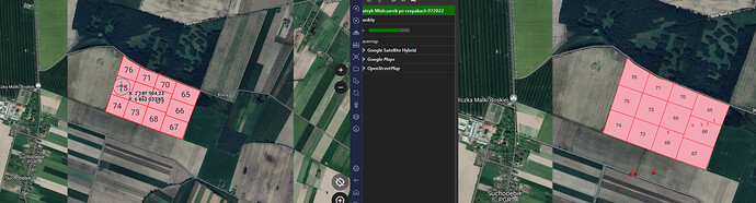

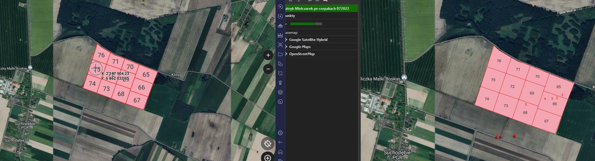

I tested now pushing changes again and I can push to cloud but changes
after push didn’t show on qfield :confused:

Imported from GitHub comment by @Alekssssanderr on 2022-08-07T11:10:17Z
points collected on Qfield and pushed to cloud shows on QGIS after sync but on QField disappear
