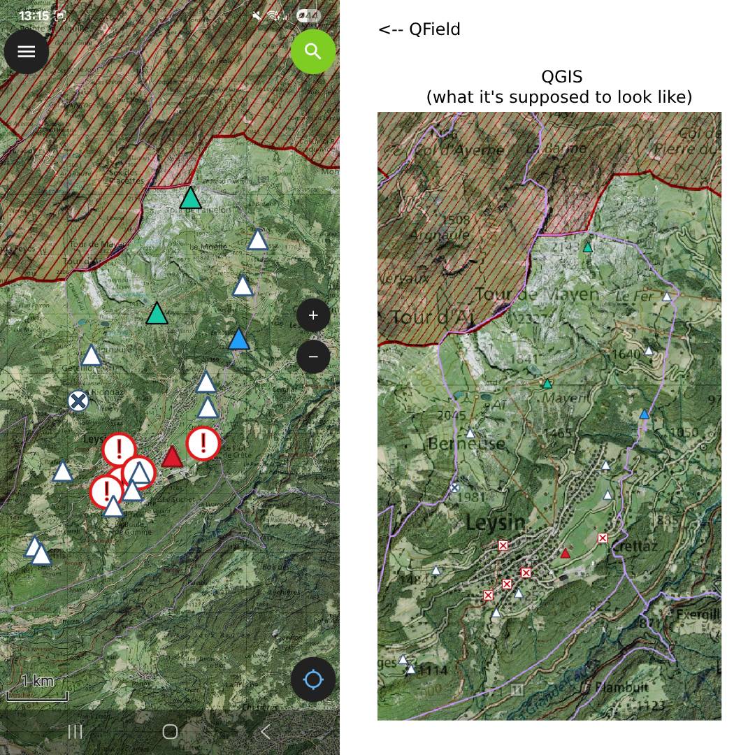

Hello!
We use QField with an organization account at work and have several collaborators.
Some of our projects include a geometry (points) with a form attached to said points and a rule-based symbology. The attribute table includes joined attributes and they show in the form on QGIS and QField without any problem.
However, the rules based on those joined attributes are being ignored by QField. It works perfectly on QGIS (3.38.3) and used to work without issue up to the 3.5.5 QField version.
Then in between 3.5.5 and 3.6.3, it worked for some collaborators but not everyone, and now that we all use the latest version of QField, we all have the same symbology issue.
Does anybody have an inkling of what might be causing this?
(For clarity sake: the round icon with an exclamation mark is the symbol we put for the ‘else’ condition)
Thank you :smiley:

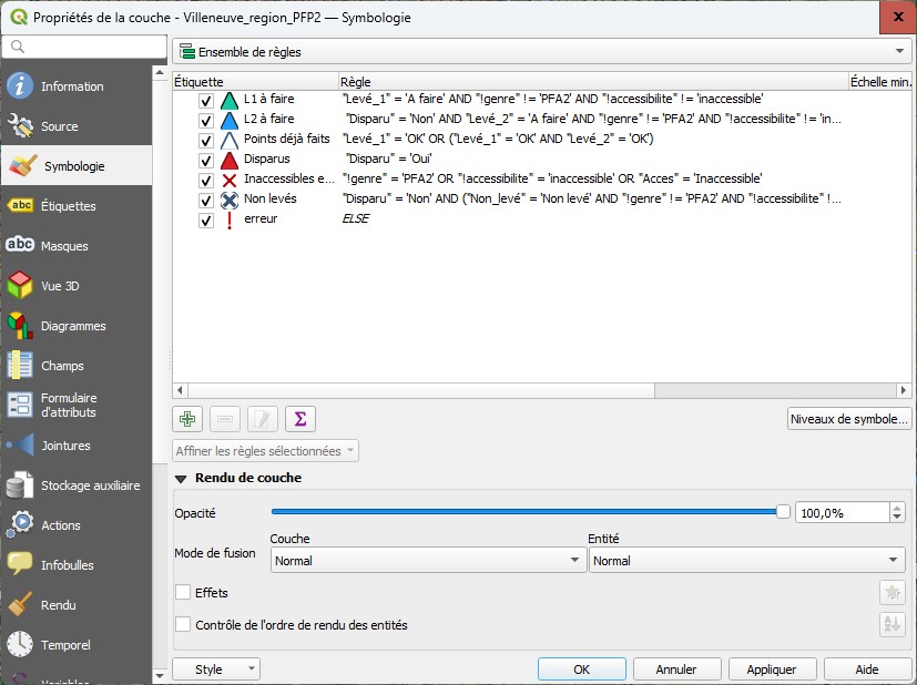

Can you share an example of the rule-based symbology? that might help us understand what’s going on
Sure! I wanted to initially but I couldn’t post more than one pic haha
Here you go:
Every field that starts with ! comes from a join but gets ignored in QField (as far as the symbology goes) despite showing up in the form. We also didn’t change anything regarding their naming convention.
