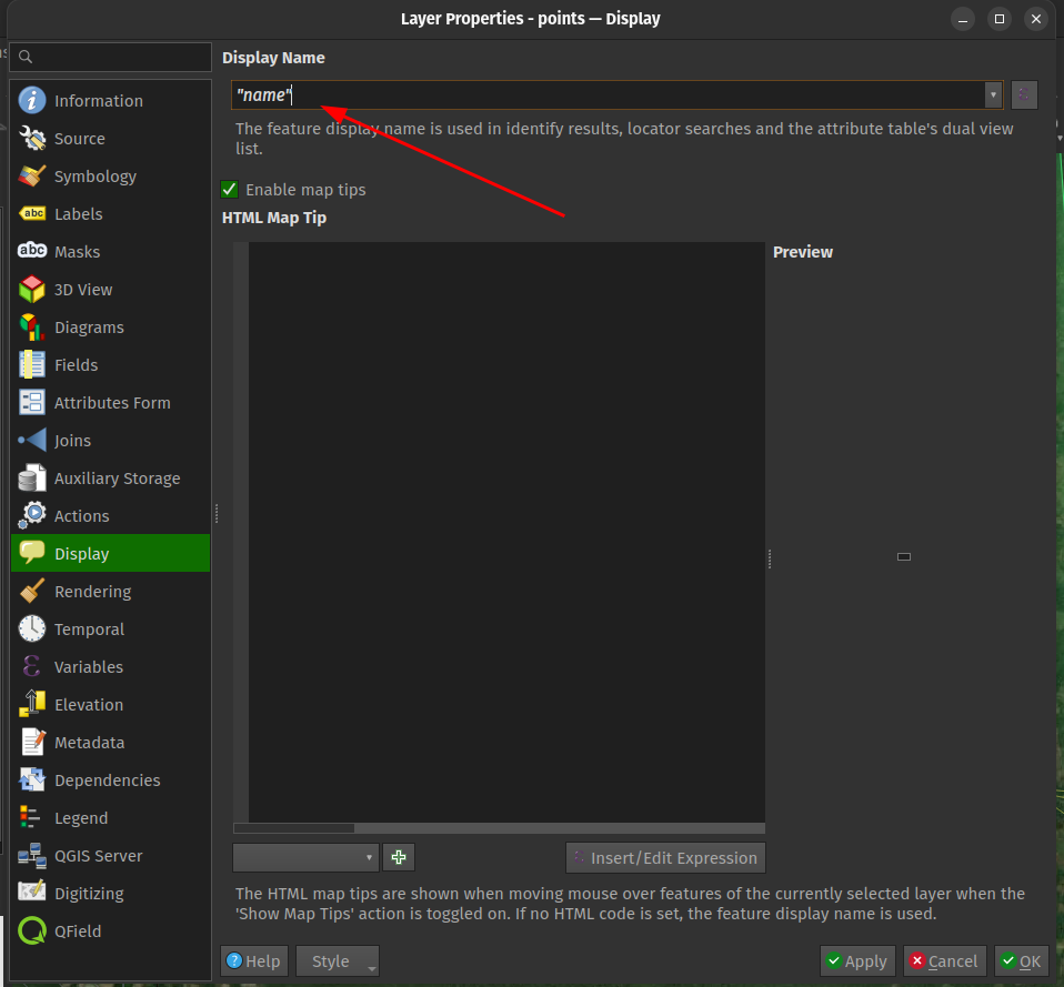

Third quebecois chiming in here :wink:
The name used in the list of children can be modified through editing the children layer’s display name property in the vector layer dialog, here:
