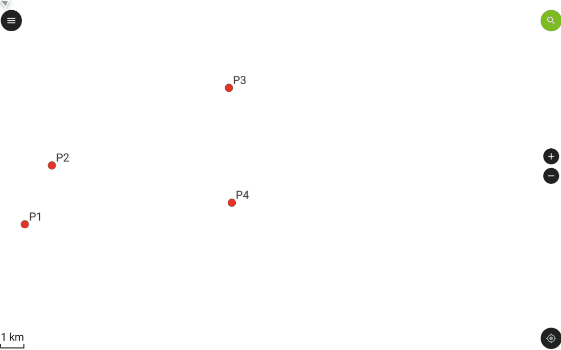

The following shows the behavior I am experiencing.
