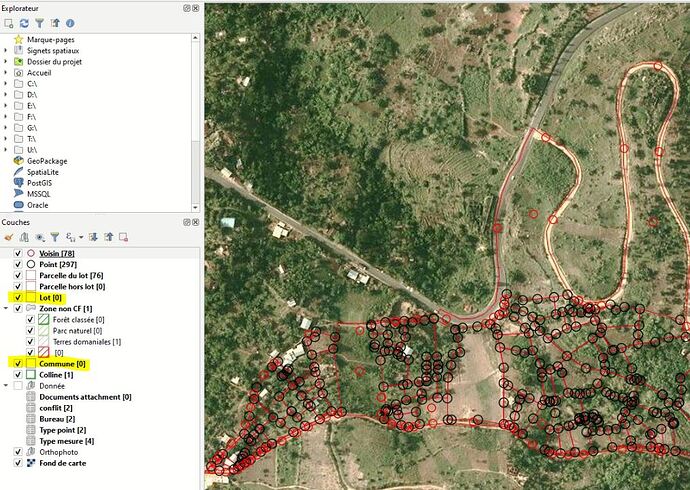

- When we send data to Qfield (Qfield project built with QFieldSync), some data are loaded as vector. Orthophoto is also loaded in same QField project (ECW tiles). Some vector layers are modifiable, some are not. (See SentToField.JPG)
- On the return from field, same Qfield project contains same data, but some vector layers have been merged with orthophoto reference map. More specifically, vector layers are still in the QField project, but empty, while their objects have been inserted into orthophoto as raster data. Merged layers were “not modifiable” layers. (See ReturnFromField.JPG)

Some vector layers have been merged with orthophoto reference map. In ReturnFromField.JPG, you can see the “lot” boundaries that are encapsulated raster reference map (overlined in yellow)
