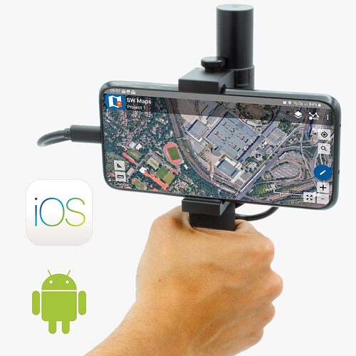

Ardusimple.
I have their RTK Handheld as well as and RTK Calibrated, both using Ardusimple simpleRTK2B boards. I have a basestation set up using another simpleRTK2B board.
All works well and no real issues

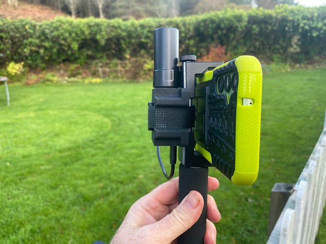

Also Ardusimple
Just using one of their handheld survey kits with Android phone, in Scotland highlands. Correction via their own App, and u-blox PointPerfect Flex RTK service (via 4G). All setup info is via Adusimple website. Lots of tutorials and information. maybe 600mm H accuracy with just unit, 10-20mm with RTK.
My first RTK unit - very happy with costs (£486) and service. Setup is very DIY and can take a while to go through various tutorials, but definitely worth it. Only have it about 2 months, so lots still to learn.Will move to static Base unit in the future once i understand more.
