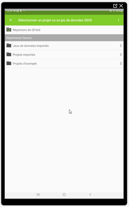

qfield
Does this replies to you need : no trace of imported project and still access to 1 recent project
Imported from GitHub comment by @vlebert on 2022-04-25T10:01:55Z
Where is this project located on your storage?
Imported from GitHub comment by @nirvn on 2022-04-25T10:03:29Z
Internal Storage/Seafile/
Imported from GitHub comment by @vlebert on 2022-04-25T10:04:26Z
vlebert , ah, can you check something for me: are you able to write to the datasets there, or merely read from it?
Imported from GitHub comment by @nirvn on 2022-04-25T10:22:57Z
Read-only indeed. Error when trying to write a feature
Imported from GitHub comment by @vlebert on 2022-04-25T10:58:04Z
vlebert , ok thanks, we should hide those upon upgrades to avoid confusion.

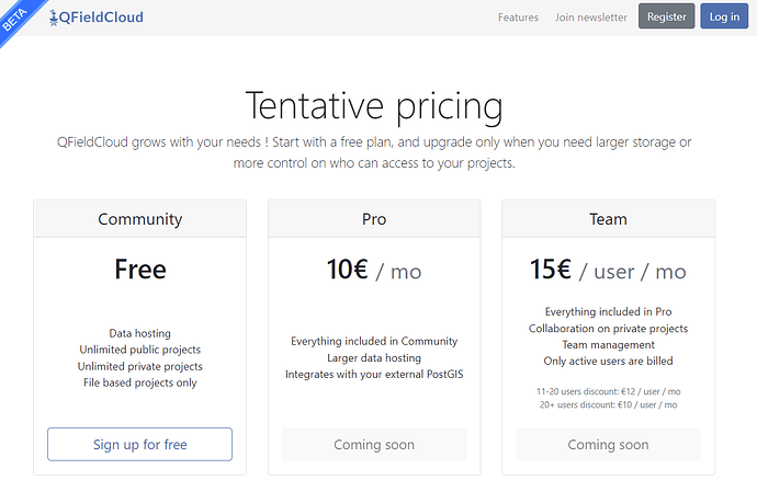

In the meantime, I can’t stress enough of good a solution QFieldCloud might be for you, please take some time to explore it. It has to be the smoothest and most secure remote deployment there is for QField. There are nice users management (multi user project access and data push, user roles, etc.) features too that could make your workflows even better than before.
Imported from GitHub comment by @nirvn on 2022-04-25T14:03:49Z
Yes I will give a try because our current workflow is reaching its limits. But I am really concern about the “coming soon”. It’s been some years it’s coming soon :upside_down_face:
What is the current storage limit ? We produce tons of JPEG… And our current workflow allow us to resize JPEGs to lower res wich in not possible in Qfield and even in natives camera apps (samsung at least)…
