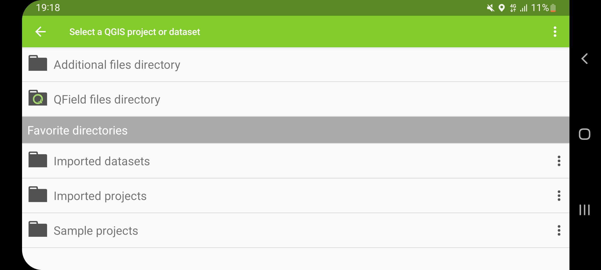

When you open QField and tap on the open local file button, you should see an “Additional files directory” folder:
This opens to your external sd card’s Android/data/ch.opengis.qfield/ directory. You can copy projects and datasets there and open it in QField.
Are you seeing this folder, and have you tried opening datasets from there?

Yes is basemaps of all projects.

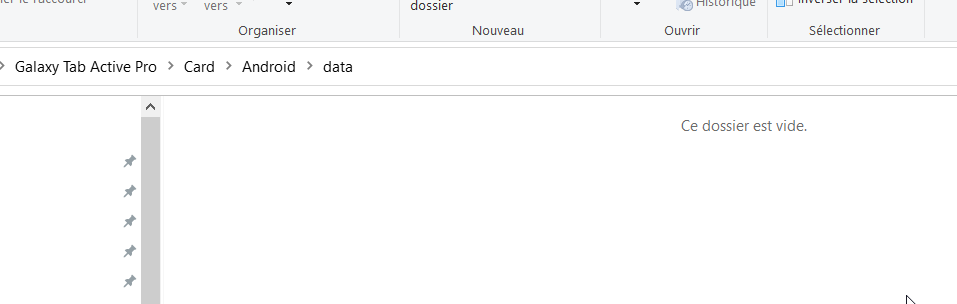

I tested and i don’t acces to this directory in App explorer and winbows explorer same view.
But i click to Additionnal files directory and i see way to the directory in sd card.

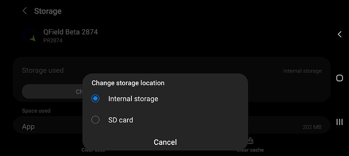

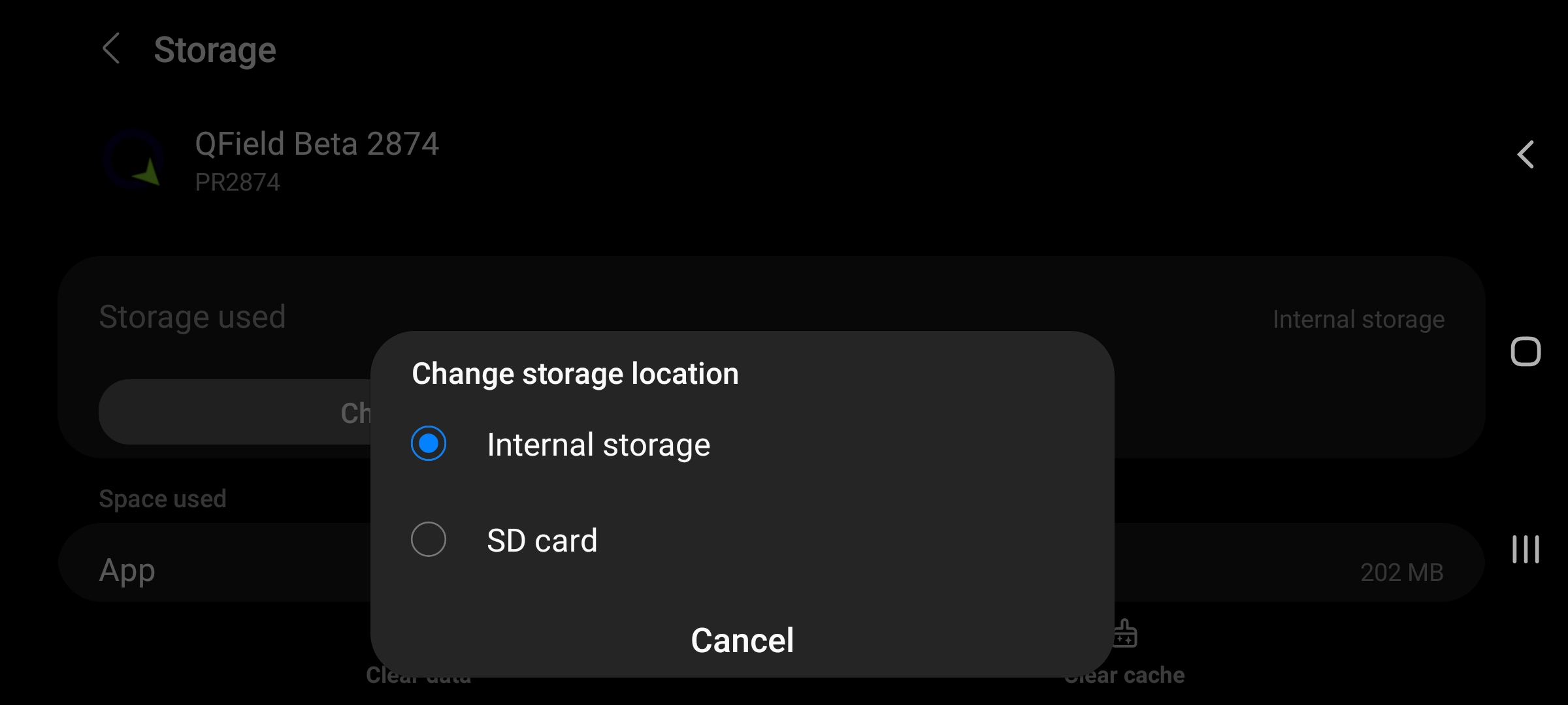

One thing can be done. You could move the storage from internal to SD card in the app properties, ie:
You find that by long pressing on the QField icon in your launcher and clicking on the (i) button or via settings → applications → QField.

nirvn I have tested this solution in first before my message.
And i see this directory in internal storage. After change storage location i have don’t new directory in my sdcard.
In internal storage, i have the full directory and imported data set my files is in internal storage.
Imported from GitHub comment by @Crapaud04 on 2022-05-10T14:38:49Z
Crapaud04 , does windows explorer allow you to create a folder in your card’s Android/data folder? If so can you try to create a “ch.opengis.qfield” folder, then a “files” child folder?
Imported from GitHub comment by @nirvn on 2022-05-10T15:03:09Z
nirvn Is not possible in windows and explorer app Android. “access denied”
After short search on the net this problem is Google and Android 11 ans after.

I tested to connect on hub usb my sdcard. I see this folder sdcard/Android/data/ch.opengis.qfield/files but this folder is empty.
So i change storage location yesterday.
I tested to copy my files in this folder is okey. And open this files on qfield is okey.
But my project don’t see this files …
