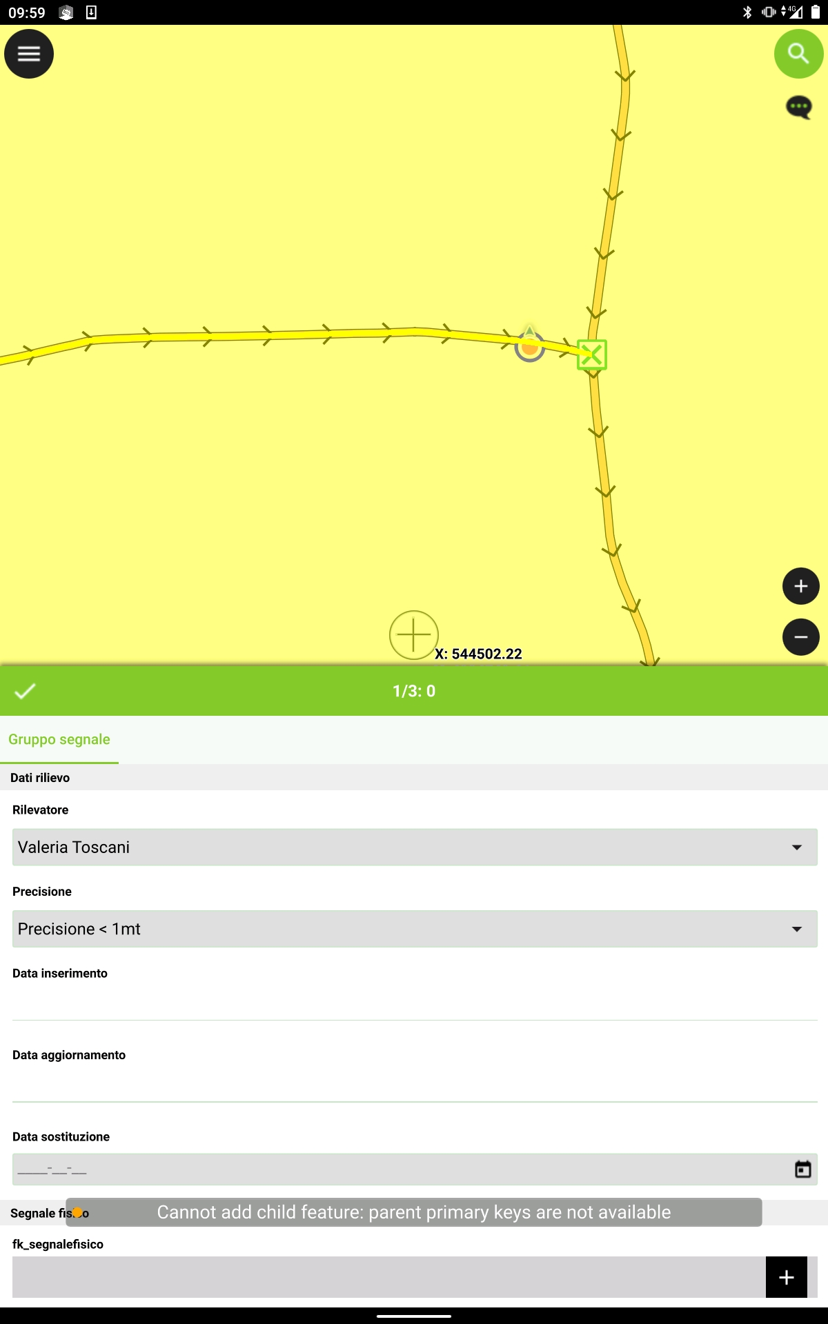

I’m currently working on a Qfield project in offline editing dealing with different PostGIS layers to be updated on field. The last test resulted in a series of problem connected to the element ID value stored and visibile in Qfield and the corresponding one in the syncronized QGIS project. Also, a layer that is part of a 1:n relationship does not allow to add a child element in its form in Qfield environment showing the following error message: “Cannot add child feature: parent primary keys are not available”. I don’t know if this two issue are connected.

Observed behavior:
The error “Cannot add child feature: parent primary keys are not available” appears on screen and the child form doesn’t open.
Also, ID is always equal to 0 for each new parent element while, after importing the project back in QGIS, a different number ID is stored in the Attribute Table.
This happens only with newly created element in the parent layer. It does not happen with element already existing in the parent layer in the project for which it is easily possible to add child features as expected.
