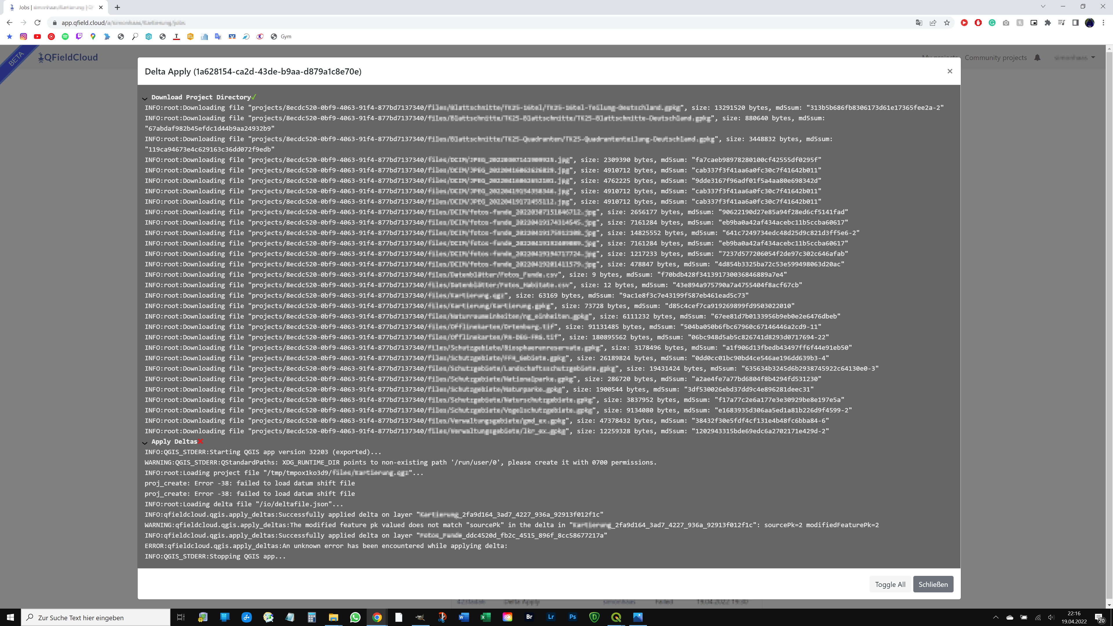

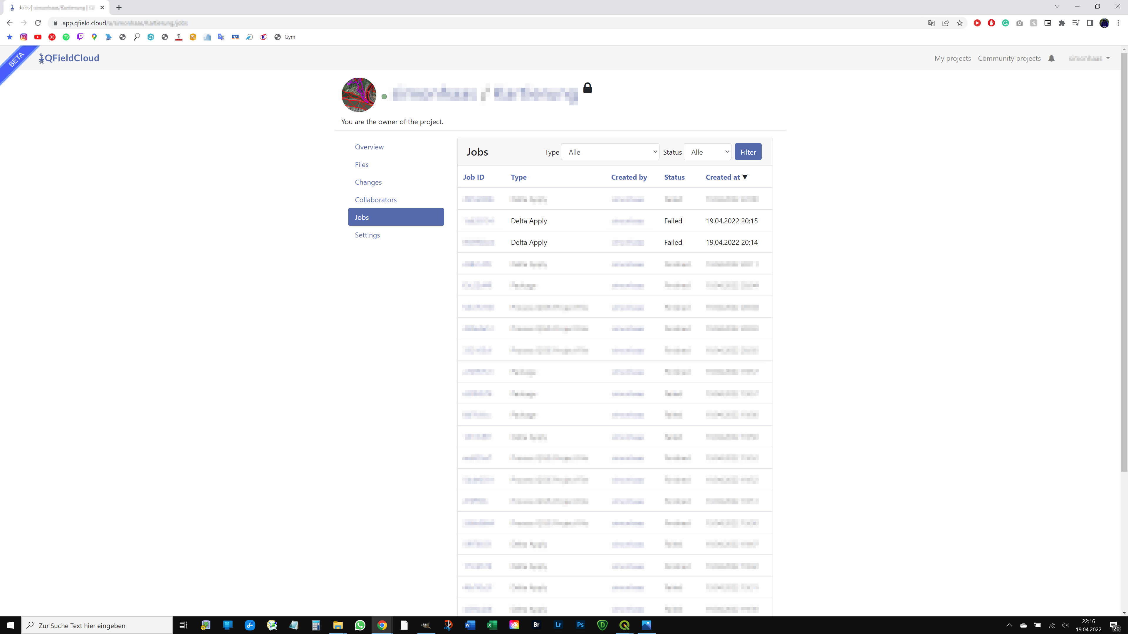

However, when adding points to the .gpkg file and also adding pictures to the child tables, synchronization stops working. The statuses of the changes to the .gpkg and .csv files are first listed as ‘Started’, however, both change to ‘Error’ quickly. The image files themselves are being uploaded to the cloud successfully.
I have tried setting the action of the failed changes to ‘Apply’, and clicked ‘Save All’. Afterwards, I clicked ‘Yes, apply pending changes’, which lead to the error message ‘Server Error (500)’.

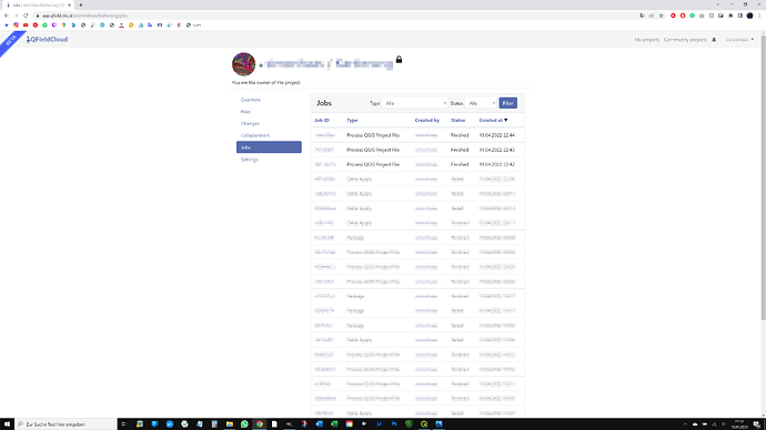

Here are a few screenshots of the failed changes in the ‘Jobs’ section, which might be useful:
(I don’t know whether these screenshots contain any personal information, so I generously blurred them. I hope I didn’t cover any important details)
Trying to do the same thing using the QGIS application on Windows 10 didn’t work either. Under the ‘Changes’ section, the status also displays ‘Error’. (However, in this case, there are no jobs with the type ‘Delta Apply’ in the ‘Jobs’ section. Instead, there are jobs with the type ‘Process QGIS Project File’, which all have the status ‘Finished’)
