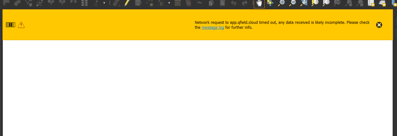

Hi everyone,
I’m getting this error when I tried to sync some information to the cloud using the plugin in qgis. I tried this with different vector layers and I got the same result.

hello, gi921120 ,
Looking at your screenshot, it says the request timed out. Did you wait a lot? Can you share a bit more details about your setup - QGIS, QFieldSync versions. Have you tried in a new QGIS profile?

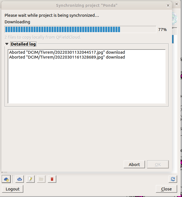

I am facing a similar issue
qgis version 3.16.3-Hannover
qfield sync Installed version | 4.0.0-BETA17

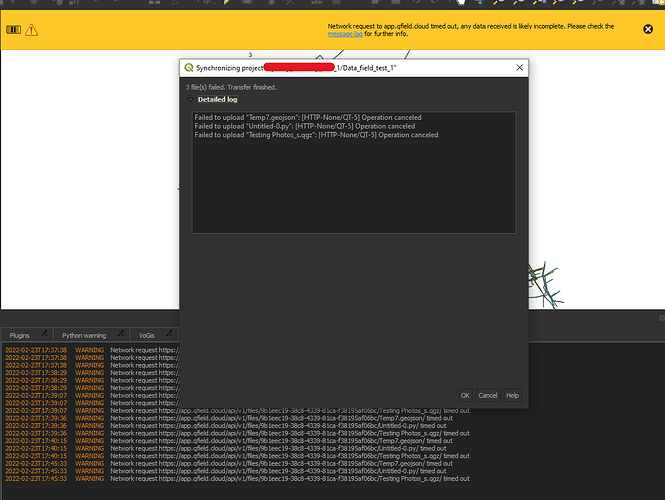

Hi Ivansuricactus,
I didn’t wait at all, I received the message inmidiately when I tried syncronizing some information. I tried creating and empty the project in the webview and then I opened it and sync the information with the plugin. Similarly, I tried creating a simple project with some vector information with “Convert currently open project to cloud project” and received the same message. Please see picture below.
Please let me know if you want me to send you screenshots of the whole routine.
