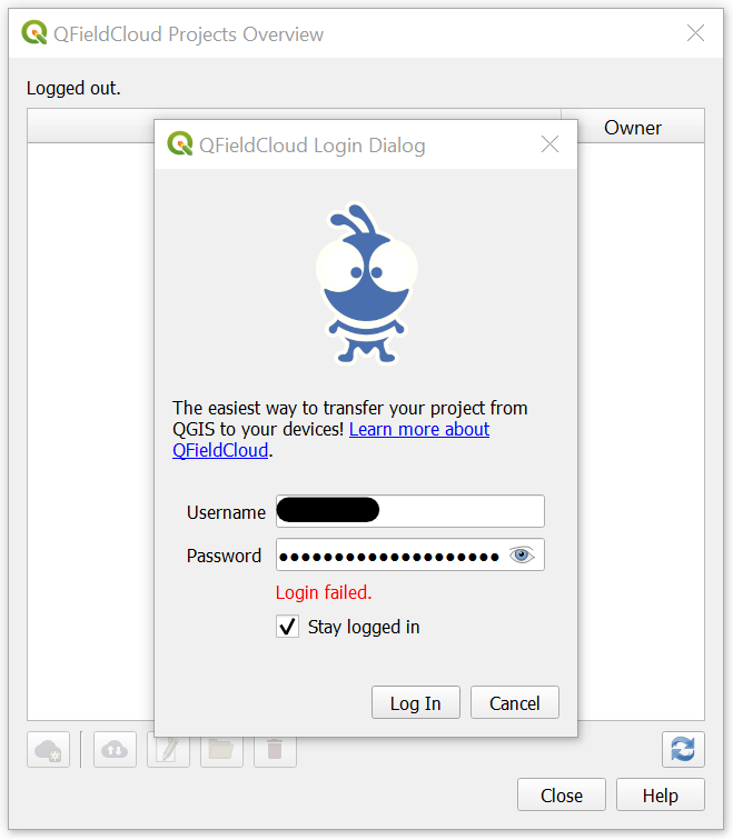

Hi,
I’m encountering a problem when trying to log into my QFieldCloud account in QGIS (3.22.3 on Windows 10 Pro). I don’t know whether it is a software bug or a mistake on my side. I have tried restarting my computer, re-installing QGIS, re-installing the QField Sync Plugin, as well as changing my password to different lengths.
So far I haven’t been able to find a solution/explanation to this problem, so I would be glad if somebody could help me fix it.

To summarize, all of you:
- have been invited recently to QFieldCloud.
- successfully registered and managed to login using the web ui at app.qfield.cloud;
- you are all using QGIS on Windows;
- you have tried to login using QFieldSync BETA18 and the zipped QFieldSync above. It starts, but when you enter your correct credentials, you get a “login failed” feedback.
If this is the case, may I ask you for two favors:
- enable the “debugging/development tools” panel from QGIS: View->Panels and grab a screenshot after your try to login. You should see something like this:
- try with an older version of QFieldSync, e.g. beta17 or beta16 from here https://plugins.qgis.org/plugins/qfieldsync/ .
Thank you for testing QFieldSync beta!

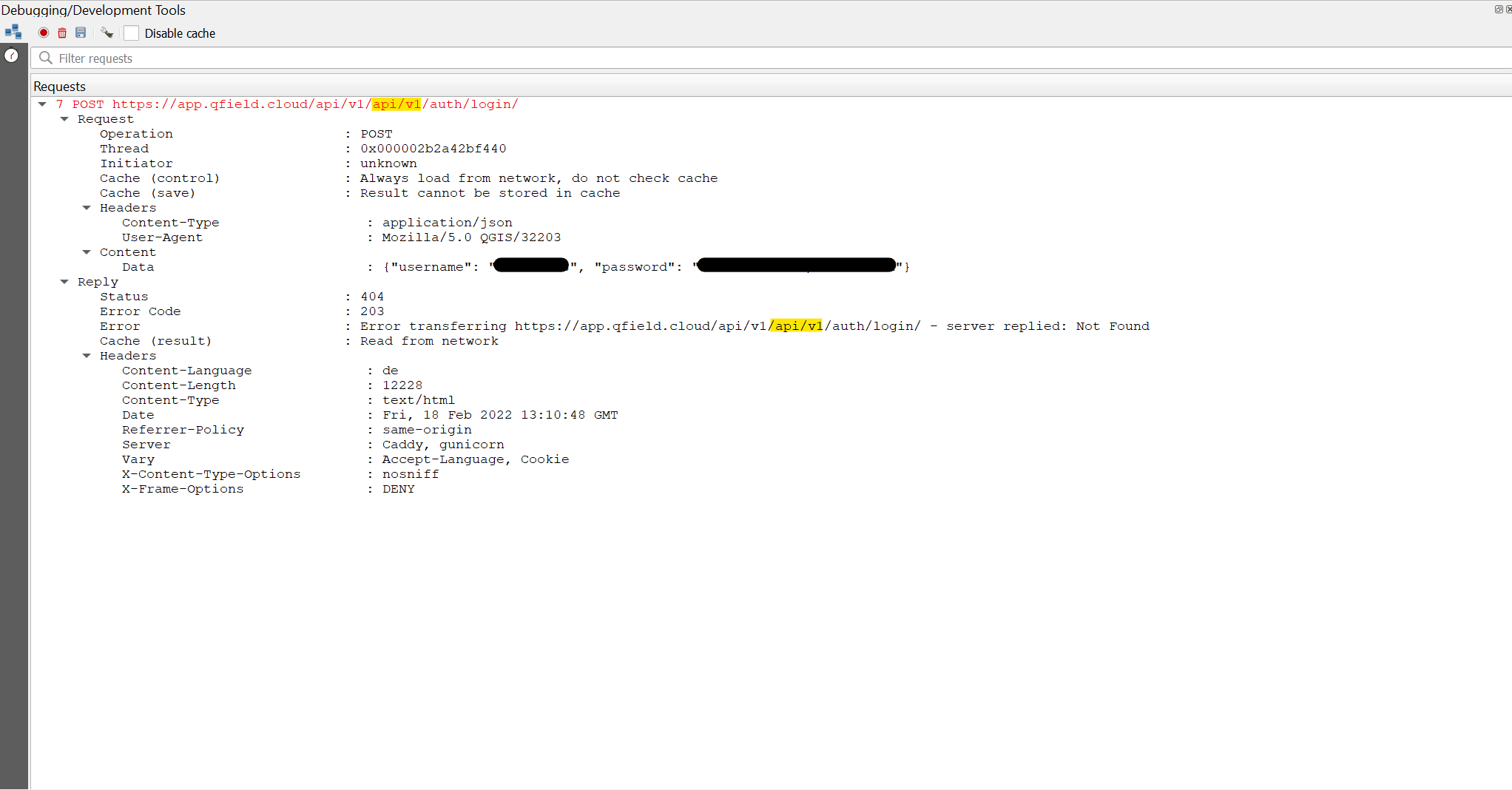

Hi suricactus,
Your summary is correct in my case.
I’ve tried using older versions of QFieldSync, but the results stay the same.
Note: ‘api/v1/’ appears twice in the login URL, which seems a bit suspicious. When entering the URL from my screenshot into a browser, it says: Page is not found (404). However, the URL without the second ‘api/v1/’ seems to exist.

Hi, SimonHHaas . Thank you a lot! This is exactly what I suspected and tried to prevent in the qfieldsync version I attached above. I will post another solution very soon, thanks for your cooperation!

Hi,
Having the same issue.
This is the result from the Debugger panel.
I’m using 4.0.0-BETA18. Will try to downgrade to older versions as suggested above and post the results.
Update: Tried downgrading to BETA17, BETA16, BETA15 (login failed on all three), and finally BETA14 (which seems to be where the cloud functionality was still not introduced).
Looking at the API path:
Error: Error transferring https://app.qfield.cloud/api/v1/api/v1/auth/login/ - server replied: Not Found
It seems that /api/v1 is repeated twice.

SimonHHaas Jimzi laotzu69 gi921120 joekbullard (from Qfield cloud log in issues · Issue #388 · opengisch/qfieldsync · GitHub)
Please check the latest QFieldSync BETA 19, it should fix your issues. Sorry for the inconvenience. Thanks for testing QFieldCloud and QFieldSync during beta phase, your feedback is invaluable.

Hi suricactus,
Updating the QFieldSync plugin to beta19 did fix the problem. Thanks a lot for your help!
