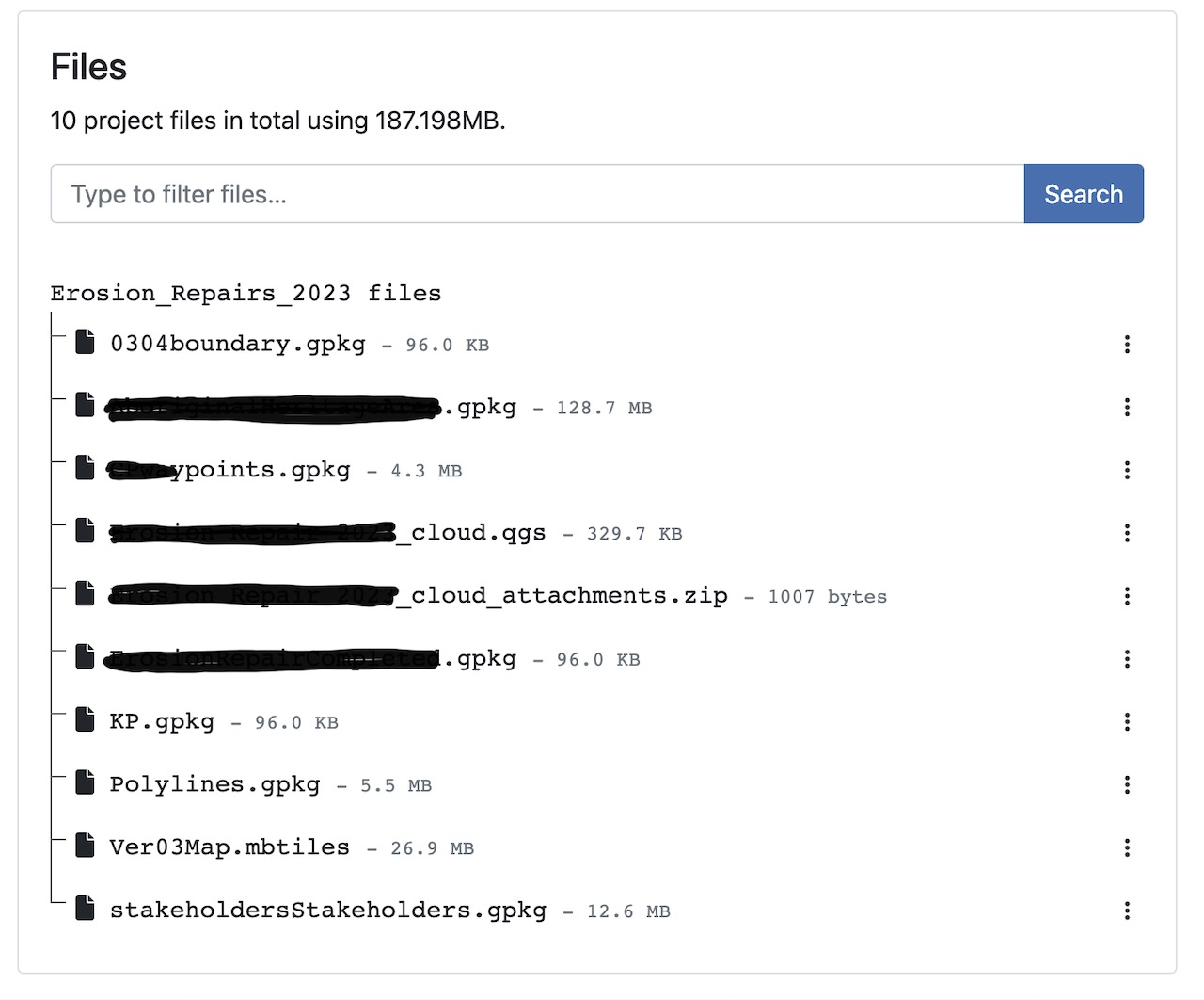

It has uploaded to QFieldCloud without issue and is only 26.9MB. I’ve checked in QFieldCloud online and the file is there, but isn’t being displayed.
The file has been selected as the Base Map in the Project Properties.

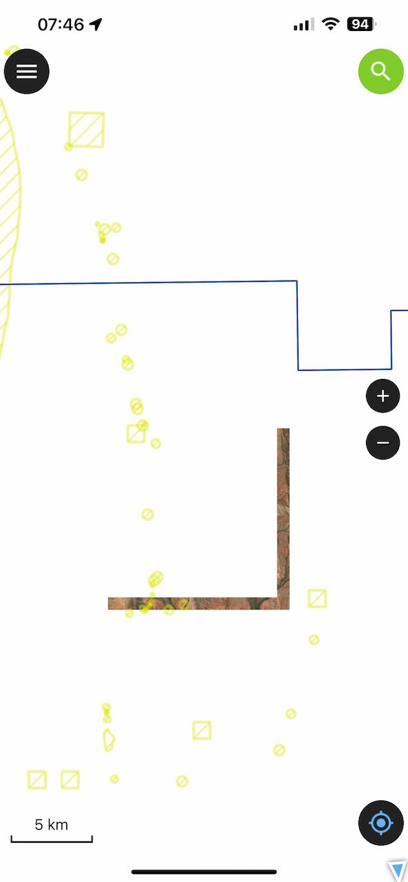

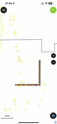

Well I haven’t had much luck in getting the images to show in Qfield when out of mobile (cell) coverage. After my issue yesterday was resolved, I applied that check to this process as well and now all I see is a portion of the edge of the image.
From this I can see that the image is where is should be, but it simply won’t load. The file is 182MB - is that too big? Should I be making them smaller and if so, what is the optimum size per image?

martingeh , actually, there’s a known issue on iOS whereas JPG datasets aren’t rendered. I’ve just checked your mbtiles, and the tile format is JPEG. You could try to create a mbtiles using PNG8 for the tile. It’ll result in bigger GPKGs but it might very well unlock it for iOS.

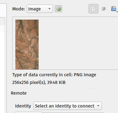

martingeh , actually, I’m 100% sure it’ll work with mbtiles if you set the tile format to PNG.
The little you see rendered (i.e. the flipped L) are individual tiles saved in PNG format due to need for an alpha channel as the region doesn’t fully cover the tile:
So you’ve got your solution.
