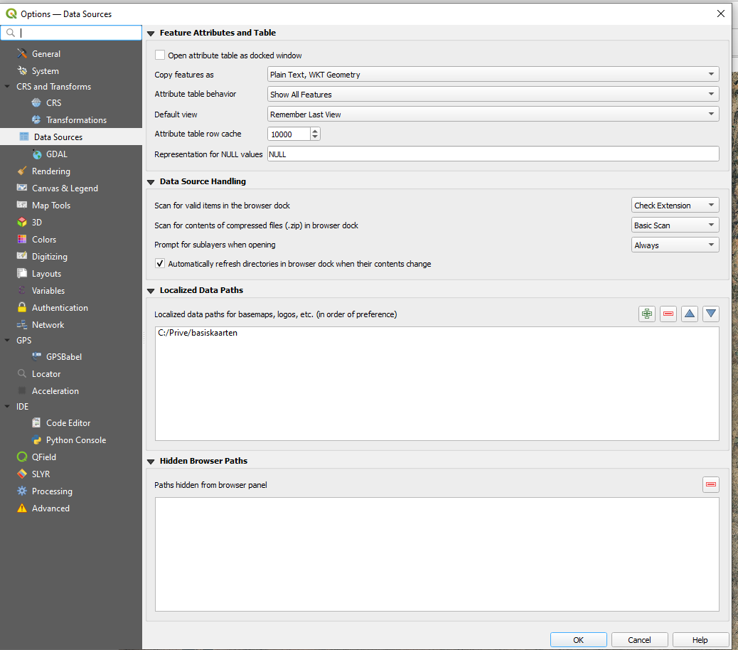

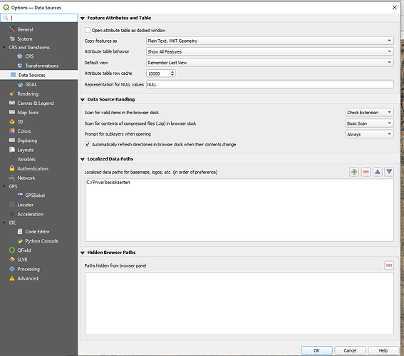

  • QGIS > Settings > Options > Datasources: localized data paths → added “C:/Prive/basiskaarten”. (printscreen 1)

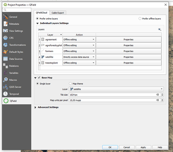

  • Project Properties - QField: “satellite” → directly access data source + added as basemap (see printscreen 2)

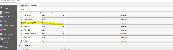

If you create a local data path in QGIS and put your raster in there, you need to remove the raster from the QGIS project, restart QGIS and then add the raster to the project. Save the project, then sync via cable. To verify if QGIS/QFieldSync recognizes the raster data as coming from a localized path, in QFieldSync options it should look like in my screenshot:
