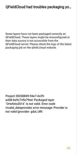

i’m trying to use an outside layer as a basemap as described in the documentation here : Shared local datasets - QField Ecosystem Documentation and it’s working fine if i export my project using a cable. However if i try to upload the same project in QFieldCloud i get this error:
Am i doing something wrong or the functionality to use an outside layer with a cloud project is yet to be implemented?

The outside layer functionality is yet to be implemented for QFieldCloud. If you want to feel interested to speed up the development of such feature, feel free to drop us a line on info at opengis.ch email.
