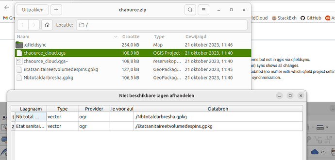

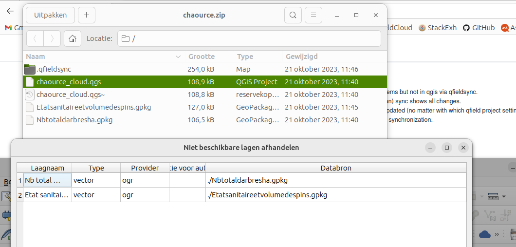

It looks like your zip file is missing both data/gpkg files. I assume they are not in the same folder as you’re project file/qgs? Perhaps that’s part of the problem.
When I unzip, there is only the chaource_cloud.qgs file.

Bonjour,
le fichier .zip est complet.
