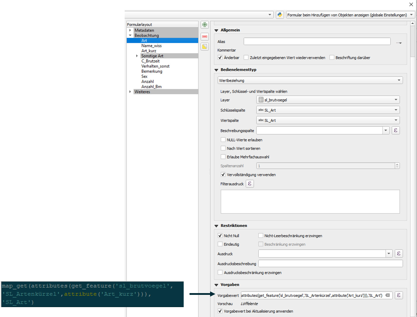

Here are my QGIS settings for the attribute form for the Brutvoegel field "Art":
Expression:
map_get(attributes(get_feature('sl_brutvoegel','SL_Artenkuerzel',attribute('Art_kurz'))),'SL_Art')

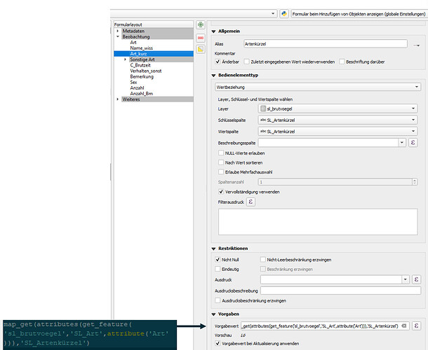

Here are my QGIS settings for the attribute form for the Brutvoegel field "Art_kurz":
Expression:
map_get(attributes(get_feature('sl_brutvoegel','SL_Art',attribute('Art'))),'SL_Artenkuerzel')
