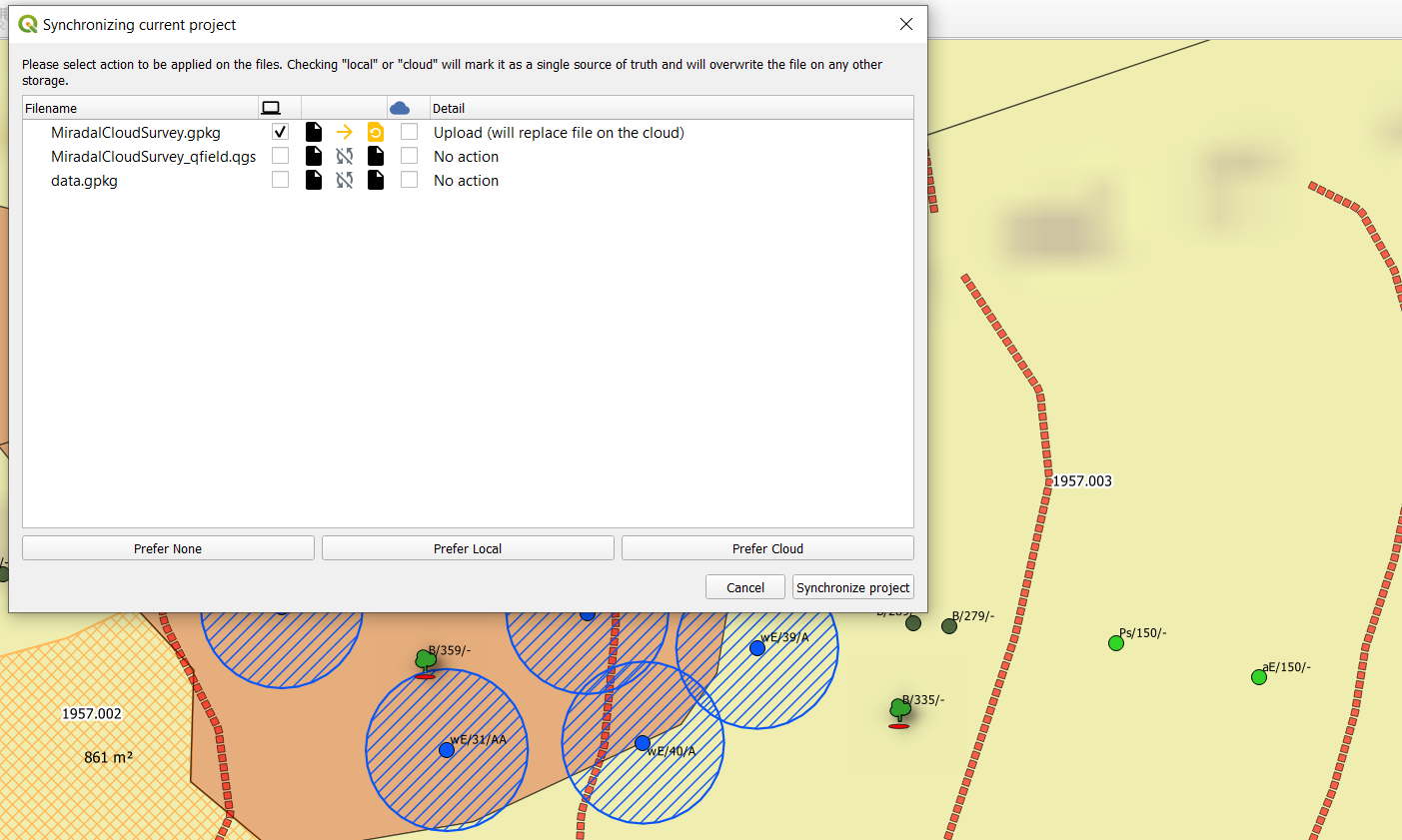

  1. In the field I have a colleague who makes changes to the project in QField and pushes the changes to the QField cloud
  2. In the office, I make changes to the project and I synchronize the project with the QField Sync plug-in 4.0.0-BETA15 (in QGIS 3.16.3)

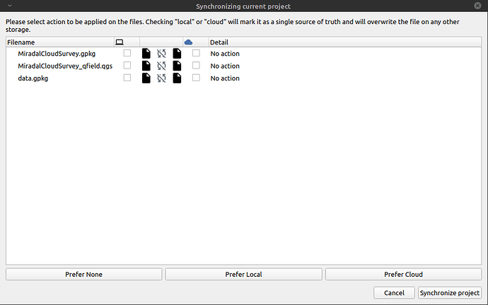

  3. When synchronizing in the office, I can prefer the local mode, the cloud mode, or the ‘none of both’ mode (see printscreen)
    4. I try the none of both mode because, I do not prefer the cloud mode (changes of my colleague), nor the local mode (the project I changed on my pc).
  4. If I prefer the cloud mode, I will lose the changes I made in the office.
  5. If I prefer the local mode, I will lose the changes my colleague made in the field
    7. After using the none of both mode, I don’t see the changes from my colleague in the field in the office on my pc (although I see the layer change/new value in the dashboard of the QFieldCloud website - see printscreen)…
  6. Then I use the local mode (imagine I didn’t know my colleague was in the field) but I lost the changes my colleague made in the field
  7. Imagine I knew my colleague was in the field, then I preferred the cloud mode (my colleague pushed the changes to the cloud) but I last the changes I made in the office…

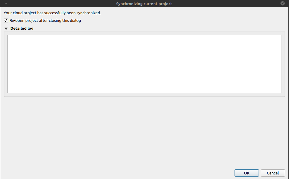

In a second attempt, I made a change in the QField app and I synchronized (in stead of pushing the changes to the cloud). I also changed a feature in the project on my pc. Again I synchronized preferring ‘none of both’. The result is that the changes that were made in the QField app are not synchronized (although the QFieldSync plug-in says the project was synchronized after using the ‘none of both’ method), the changes that I made on my pc are still there.
In other words, there is something I don’t get :frowning:
When I use the ‘none of both’ mode, I would expect that both changes will be part of the ‘new’ synchronized project. Having to choose between the local (office) or the cloud (field) version is resulting in loosing or the office, or the field changes?! In other words, then there is no synchronization with the office at all…
Please help. Thanks.

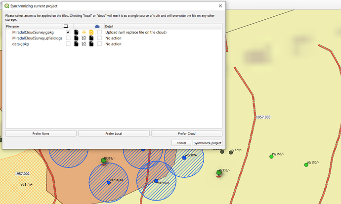

I have been using QFieldCloud quite intensive the last 2 weeks. Synchronisation is always smooth (from both sides, I mean on mobile and on pc), I never had sync errors :slight_smile:
  1. Nevertheless, uploading or downloading changes doesn’t work at once; I mean there is a kind of time-out when you want to synchronize different gpkg and qgs files. So I sync in two times (changed files not all checked for synchronization at once > see printscreen)
  2. Before working on the project at the office, I always check if field collaborators made any changes. If not, I start working on the project or make some changes in the office. If there are changes from collaborators, I first sync from cloud to local project on the pc in the office. I am just afraid that a certain moment, changes will happen simultaneous and that one of both parties will lose his changes… This seems to me to be an important point of attention (or am I overlooking something?).
