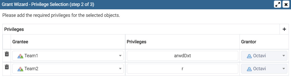

PostgreSQL allows creating different users, each one with his own authentication credentials, and roles, and designating users as members of roles. And then, it is possible to assign privileges over a particular table to a particular role.
This is the Grant Wizard of pgAdmin 4, from where the database owner can assign privileges on a table to users individually or users grouped in roles.
On QGIS, when connecting to the PostGIS data source with his/her credentials, each user will get the permissions over the layers that are associated with his/her user in the database. If he is team 1, he will be able to do all crud operations on features; if she is team 2, she will just be able to select the layer features.

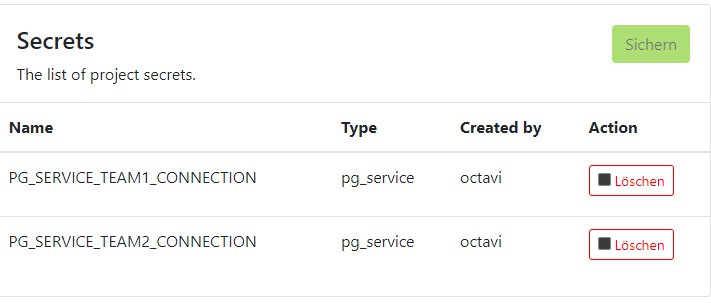

I’ve seen that it is possible to create many pg_service.conf configuration files, which contain the PostGIS database connection string, and that gives me some hope that what I intend can be done, but I don’t have a hint on how to associate a project collaborator with a specific pg_service.conf.
This makes me believe that it is somehow possible to automatically log in to the PostGIS database using one or another secret, depending on the collaborator that logs in to the QField Cloud project.

The reason why QFieldCloud supports multiple pg_service secrets is that you may connect to multiple databases within the same project.
However, switching the pg_service file based on the user is support and it is not on our roadmap.
You can control what kind of changes users can do via QFieldCloud integrated role based permission model. If you set your team1 to have editor role and team2 as reader, it matches the situation you described above.
The other way to achieve this is if you have two separate projects with two separate pg_service files for each of them.
Note the pg_service file is used only within QFieldCloud server for offline editing layers and it is not delivered to QField App devices. This might change in the next year with additional flag whether the pg_service file is available on mobile devices too.

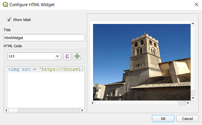

There’s a further option for downloading images from external storage and displaying them in the attributes form and it is the Html Widget.
This works partially in QField, as the image is rendered in the feature’s attributes form, but when Html widget is present, the form’s behavior goes bad, being impossible to scroll down. Why could this be happening?
Do you know of a working solution to show feature related images from an external storage in the attributes form?

Please attach a test project and open a new issue desciribing your troubles with the HTML/QML widgets on QField.
On the other discussion, I just answered here Is ist possible to get QField to access attachment from WebDAV Storage? · opengisch/QField · Discussion #2707 · GitHub . I think you can sync your project photos using the qfieldcloud-cli tool.
