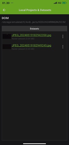

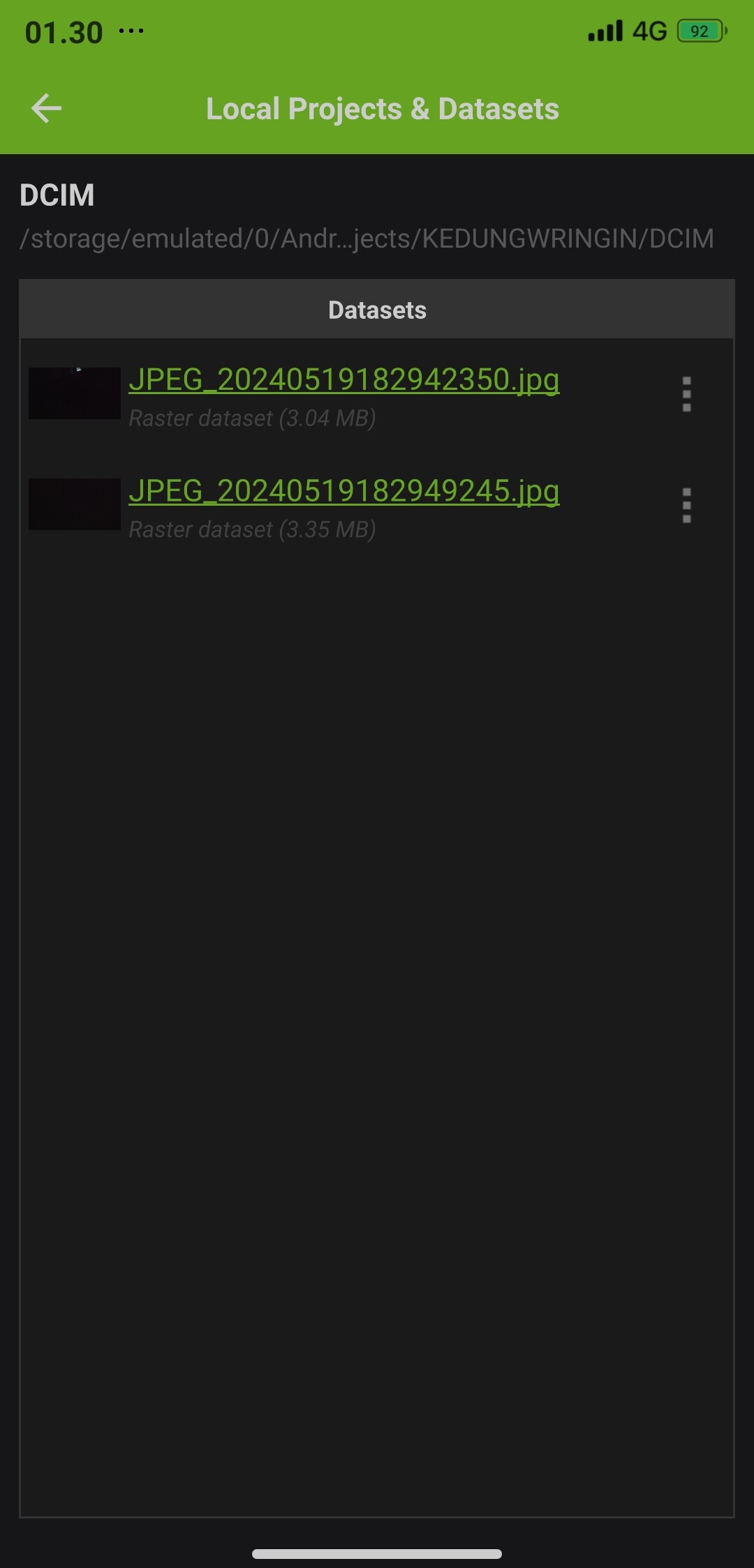

Change the name of the photo file what we want in QFIELD
Describe the issue
[How to name a photo according to the field we want at QFIELD? For example, I have a photo code field that contains the code “J0001” onwards, because every resulting image file name in qfield seems to be automatically named using the date it was taken]
Expected behavior
[I want the name of the photo after export according to the field without changing one by one, how do I do it? I think this uses a coding system. I’m not very good at it]

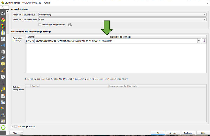

Hi,
When you have a field that allows taking pictures using the ‘Attachment’ widget, you can configure the attachments in the properties of the layer (QFIELD tab).
From there, you can use an expression to name your pictures. For example, you can use the field that contain your “codes”.

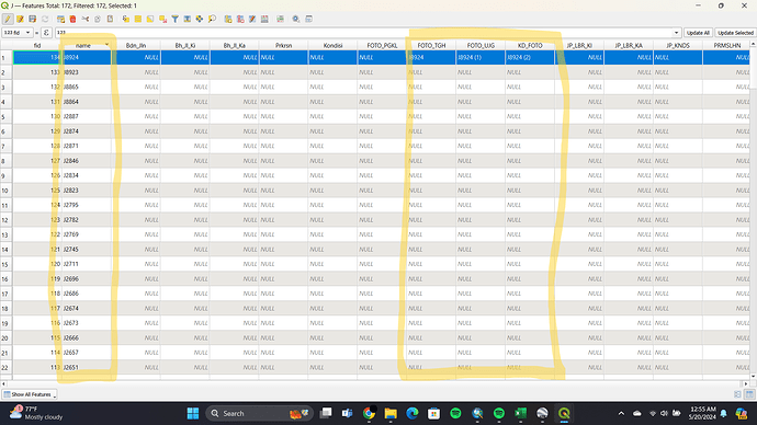

for example i want to do that can QFIELD do that?, i mean the name of file image automaticly fill like that

Hi,
I’ve done that, but the result is the same :frowning:

Imported from GitHub comment by @Ipickedausername on 2024-05-20T21:11:35Z
I am trouble shooting a similar naming issue. Pics are default named and not by the expression. I noticed however, that if I created the feature containing the pic record (i.e. saved it), then selected it and edited it to add a pic, the renaming worked as coded. Anyone else?
