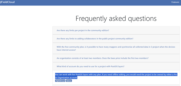

I was looking for information on self-hosted Qfield Cloud (about costs) and got this FAQ question: ‘’ You can work with live PostGIS layers with any plan. If you need offline editing, you would need the project to be owned by either a Pro or Organization account. ‘’.
So, the question is: how can I make it? Is it true?
Imported from GitHub comment by @nelsonjlle on 2025-03-05T12:32:42Z
Unfortunately, this is not allowed in the Community plan. Apologize for the inconvenience.
Imported from GitHub comment by @SeqLaz on 2025-03-05T21:09:01Z
Ok, just checking the information provided by the own developer. Perhaps it would be convenient fix the FAQ informátion.
