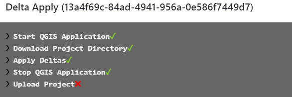

Apparently the Delta_Apply worked ( green check) but Upload did not work (red check). I ran a synchronize from my iPad. Before the sync, my three new points in utilities appeared on my iPad screen. Now the points are gone but I hope the points are still available in the system. I have read the Troubleshooting linked above but I don’t see notes on my case. I have also tried Applying the job again. The Job Status changes to Pending, then Started, then Error. I pasted the expanded printout for teh Delata_Ap-ly and Upload steps below.
Can someone help me get back my 3 new points for the Utilities layer?
Delta Apply (13a4f69c-84ad-4941-956a-0e586f7449d7)
Start QGIS Application
Download Project Directory
17:36:35.408 root INFO Downloading file “20210-PRELIM(12-22-20)_modified.tif”…
17:36:40.265 root INFO Downloading file “Floorplanver12.gpkg”…
17:36:42.219 root INFO Downloading file “NewHome_cloud_cloud.qgs”…
17:36:43.439 root INFO Downloading file “NewHome_cloud_cloud_attachments.zip”…
17:36:44.995 root INFO Downloading file “Ortho 2019.tif”…
17:36:46.270 root INFO Downloading file “PropertyFiles.gpkg”…
17:36:48.665 root INFO Downloading file “Slope Byte.tif”…
