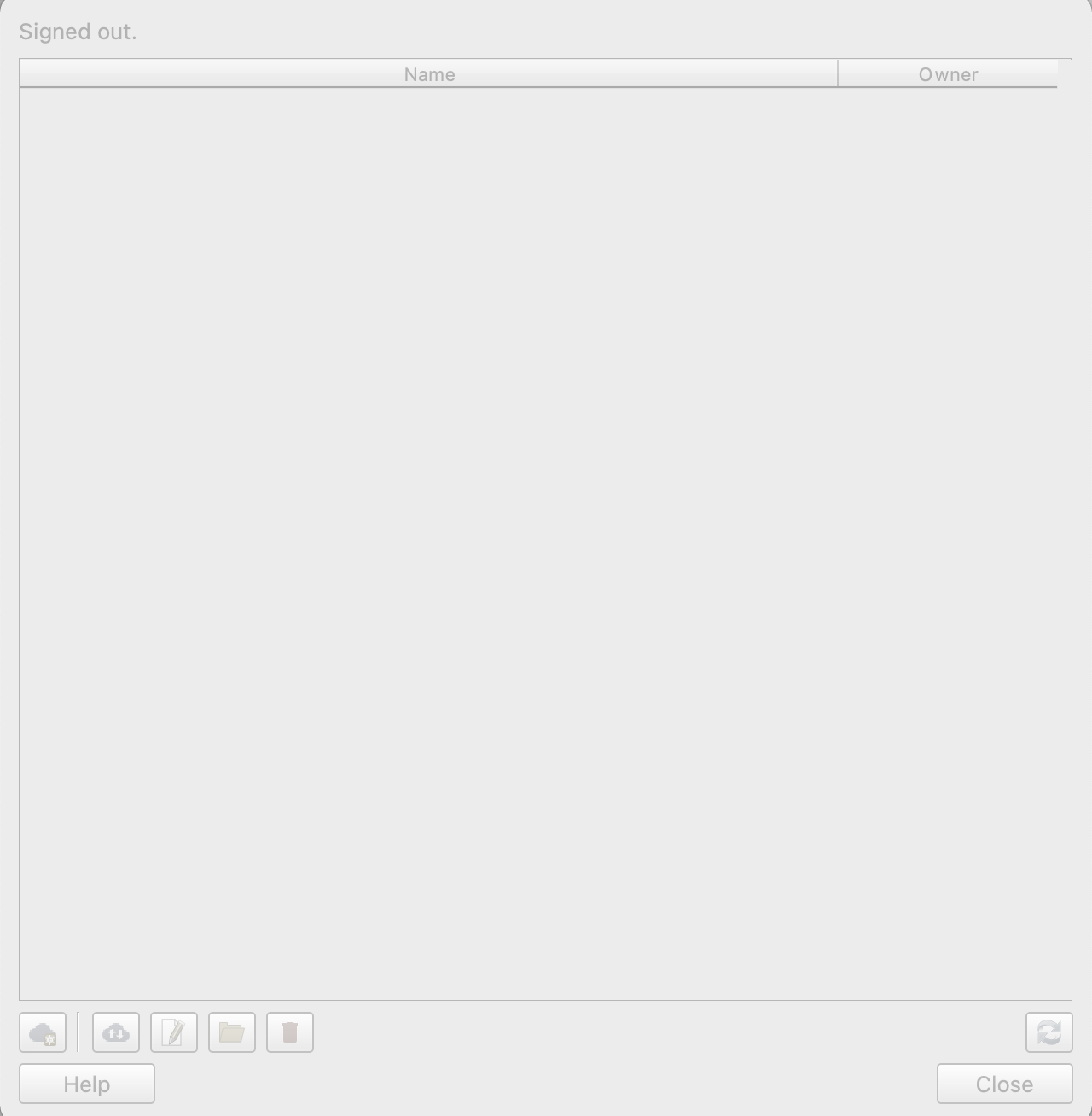

Hello,
first of all great work!
I create an account online and downloaded the plugin.
After trying to login over the blue button - nothing appears and QGIS stucks. Sync over mobile app and qcloud works. its a local machine problem.
Do I have give somewhere special permissions?
Here you find my specs.

Hi, I have the same issue also.
Looking forward to a fix and to using the Cloud in QGIS!

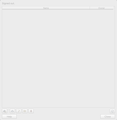

Hey NJMC qbsho , thanks for reporting your issues. I believe you are missing the login dialog somewhere between your QGIS windows.
Here I posted the disabled projects dialog on the right and the login dialog you need to use on the left.

Yes, thats correct.
So switching through open tabs didn’t work out.
Finally after moving the the whole application to a new screen and switching the focus with the cursor the dialog appears somewhere.
Was able to move it to the right place and fix the issue.
Maybe setting higher dialog view hierarchy index will fix it by default.
Thanks for you support!
Imported from GitHub comment by @qbsho on 2022-04-19T08:04:00Z
This seems to be an MacOS problem, will try to find a fix!
